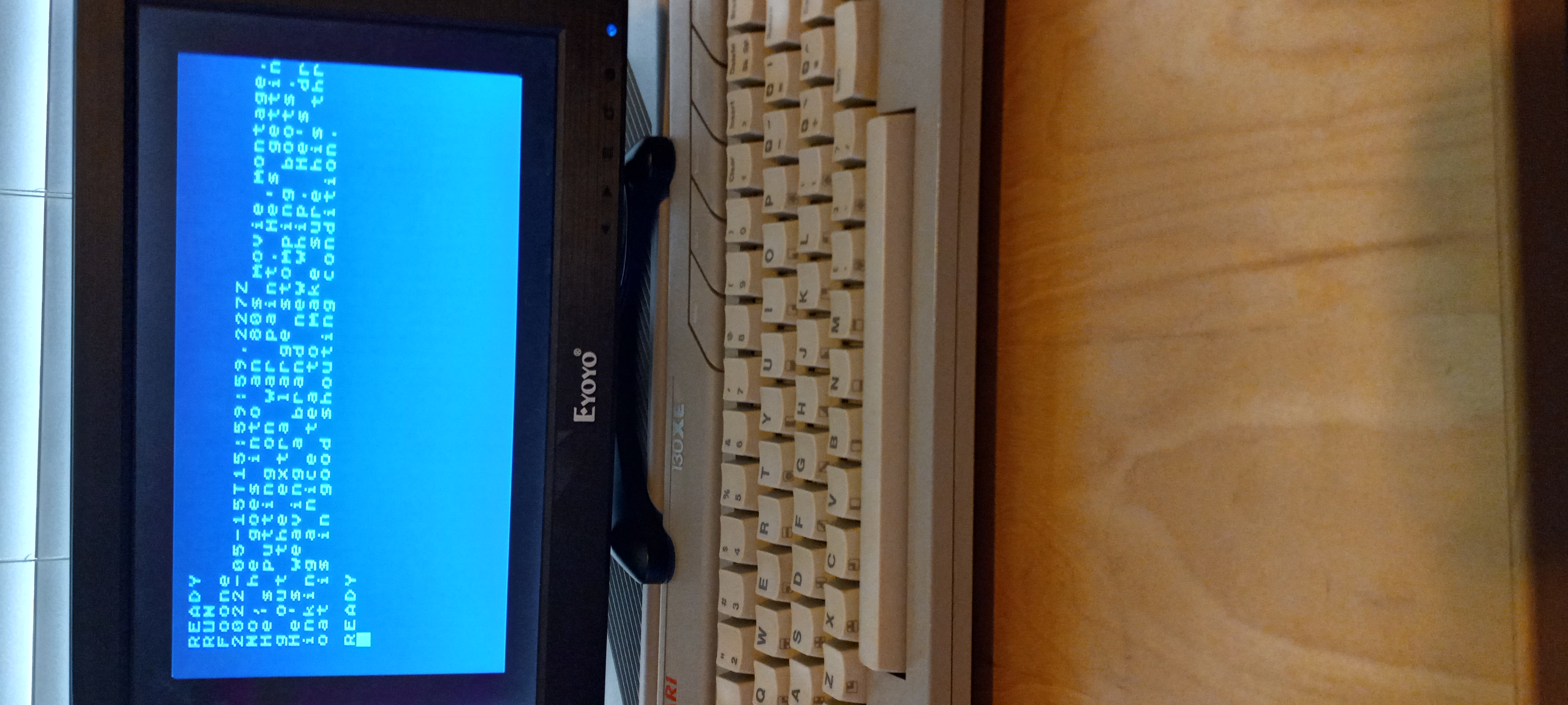

An example of this, is the world's simplest Mastodon client, written in ATARI BASIC, which displays the newest public post:
Code: Alles auswählen
0 DIM A$(256)
10 OPEN #1,12,0,"N:HTTPS://oldbytes.space/api/v1/timelines/public?limit=1"
11 TRAP 91
20 XIO 252,#1,12,1,"N:":REM  SET CHANNEL MODE
30 XIO ASC("P"),#1,12,0,"N:":REM PARSE JSON
40 XIO ASC("Q"),#1,12,0,"N:/0/created_at"
50 INPUT #1,A$:? A$
60 XIO ASC("Q"),#1,12,0,"N:/0/account/display_name"
70 INPUT #!,A$:? A$
80 XIO ASC("Q"),#1,12,0,"N:/0/content/"
90 GET #1,A:? CHR$(A);:GOTO 90
91 CLOSE #1:END
Yes, really, that's it.
And you get something like this:
It will be in the next released build for both Atari and Coleco Adam, which will be released very soon.
