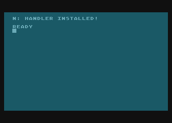

Ok guys, for those of you who REALLY KNOW #Atari SIO and handler loading, I need help:
I have checked in a new test:
https://github.com/tschak909/atariwifi/ ... /cio4-poll
Which literally tries to utilize the Atari 850 handler bootstrap method to load in the N: driver I've been developing.
So far, I have been able to:
* Answer the type 1 poll, with an appropriate DCB for a loader program, that loads into a fixed location $1D00
* The SIO request is honored, loader shows up at $0500, jump to $0506, which sets up ANOTHER DCB to load the handler at $1D00.
* The loader then jumps to $1D01, which, ultimately goes into a loopty-loop, as AUTORUN.SYS gets loaded over and over again with a corresponding long beep.
I have tried to daisy chain DOSINI by saving it at the beginning of main(), setting a new DOSINI value (to point to my main()), and then jumping to the value I saved. but it loops.
Really wanna know why. Because this has kicked my arse, every step of the way, all day.
(and no, the 850 source code isn't much help, it's a highly compressed bowl of pasta in the expediency of conserving ROM space)

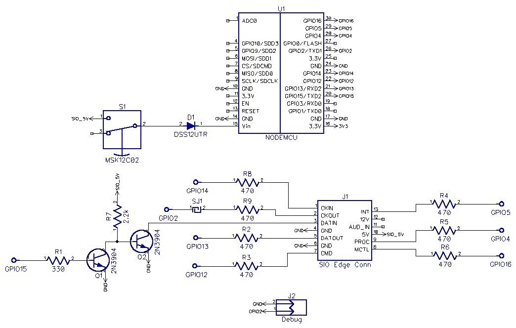

Ja, aber ich habe auch anderen geholfen, die ihre eigenen bauen. Der Schaltplan für das Interface-Board befindet sich im AtariAge-Thread.
-Thom

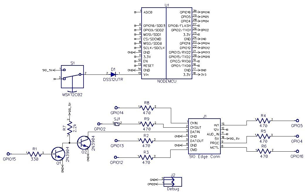

Hier ist der aktuellste Schaltplan:
Ich bin ehrlich gesagt mehr daran interessiert, dass Leute diese Hardware einsetzen, als Tonnen von Geld damit zu verdienen.
-Thom

I understand, am just trying to get people interested, and even looking at the schematics for what we have and building some units. :)
-Thom

von dl7ukk » Sa 25. Jan 2020, 18:48
Hello Thom,
the CIO handler "N:" has been used before. For the device "Null" (like Linux /dev/null).
Here is the source
Code: Alles auswählen

(Magazin Antic 1989)
Screenshot Emulator
NULLHAND.BAS.7z
(477 Bytes) 530-mal heruntergeladen
