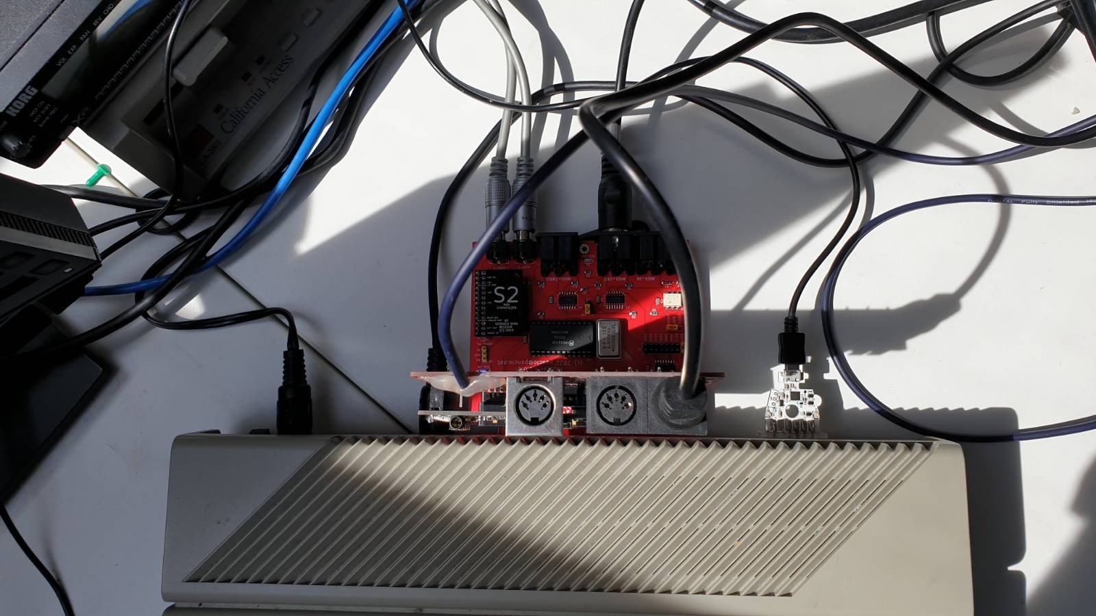

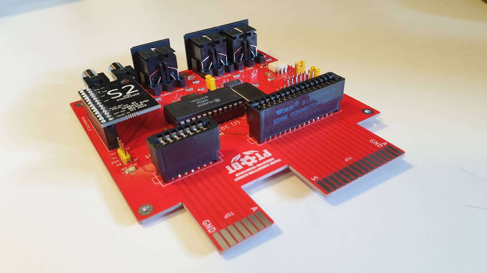

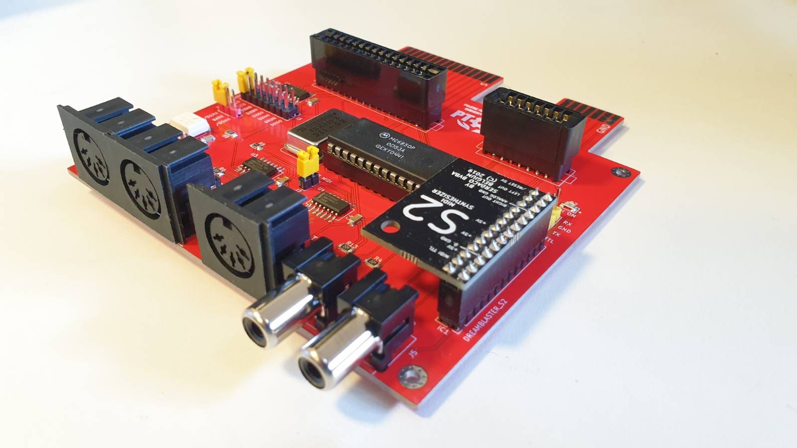

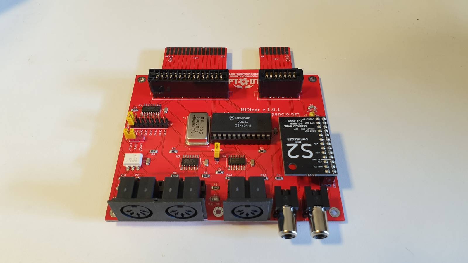

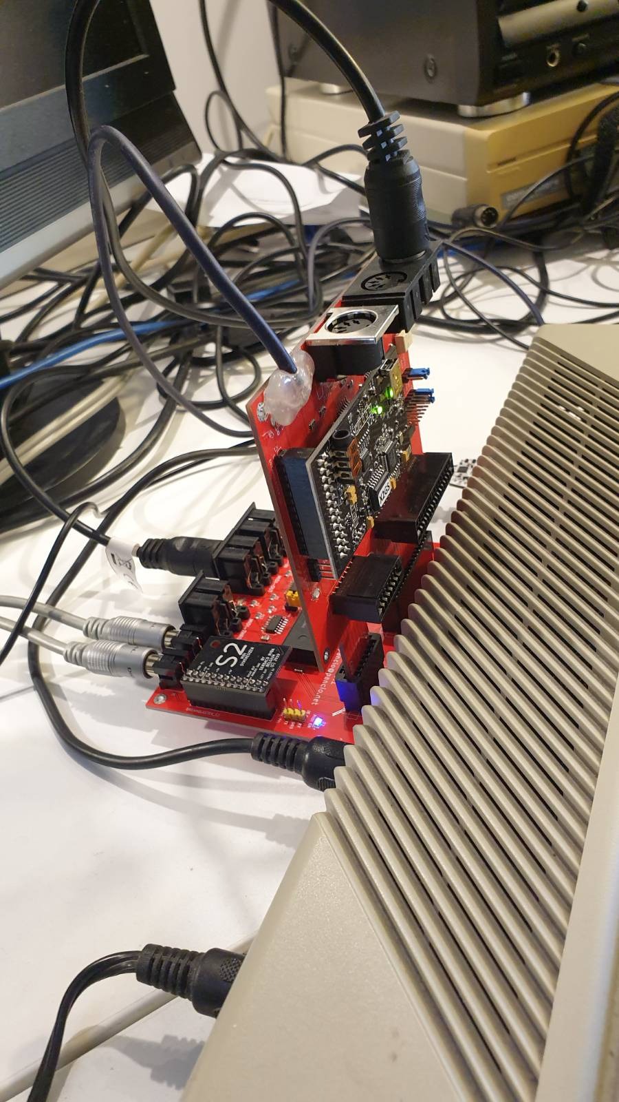

I would like to present new device for Atari XE series which can play/record MIDI files on Atari 8-bit computer. Idea was taken from SIO2MIDI
but I decided to use CART/ECI port to communication with MIDI devices because in case I may use SIO independently for load/save data during MIDI working. In case possible it to use MIDI
sequencer based on Atari with direct access to FDD and/or other mass storage device, for example with AVG CART.
Additional features:
- possibility to play external MIDI source like MIDI keyboard or synthesizer,
- MIDI IN/MIDI OUT LED indicators on board,
- serial communication with 31250 b/s, 125 kb/s or 2mb/s with PC (using e.g. FT232 dongle),
- fully transparent for other cartridges/interfaces (based on D1XX/D5XX address decoder),
- equipped with S2 DREAMBLASTER is ready to play (similar like SIO2MIDI,
First issue of MIDIcar v1.0 is dedicated for Atari XE series but I’ll prepare version for XL series as soon as possible.
I hope, good player will be prepared soon :-)
Wenn ein ABBUCer daran interessiert ist, bei der Softwareentwicklung zu helfen, stellt pancio ein Board zur Verfügung. Bei Interesse kontaktiere bitte pancio oder Sleeπ.
There is first couple of sounds from MIDIcar played on Atari...

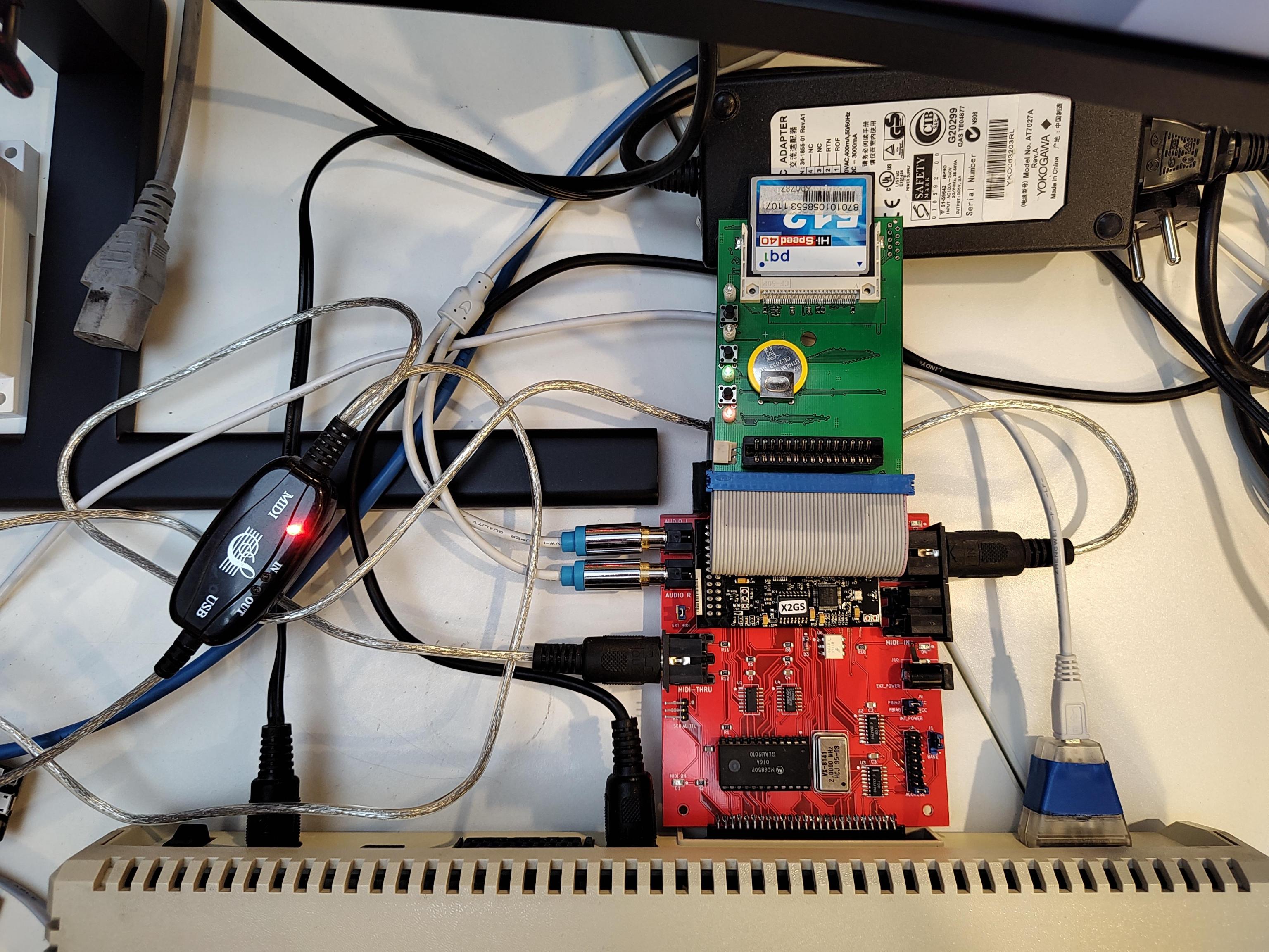

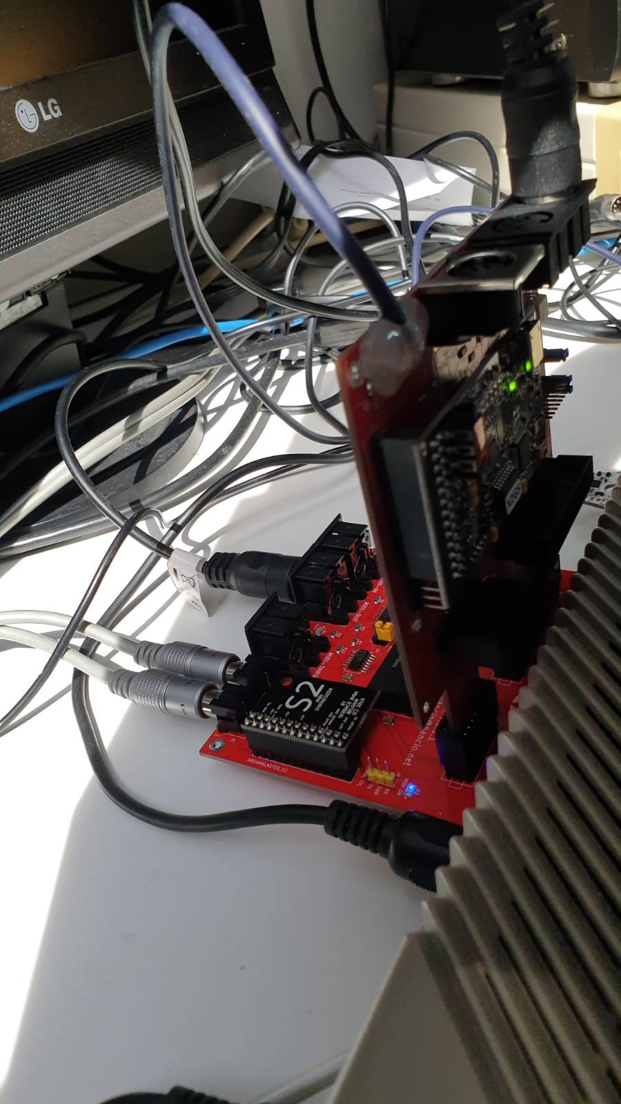

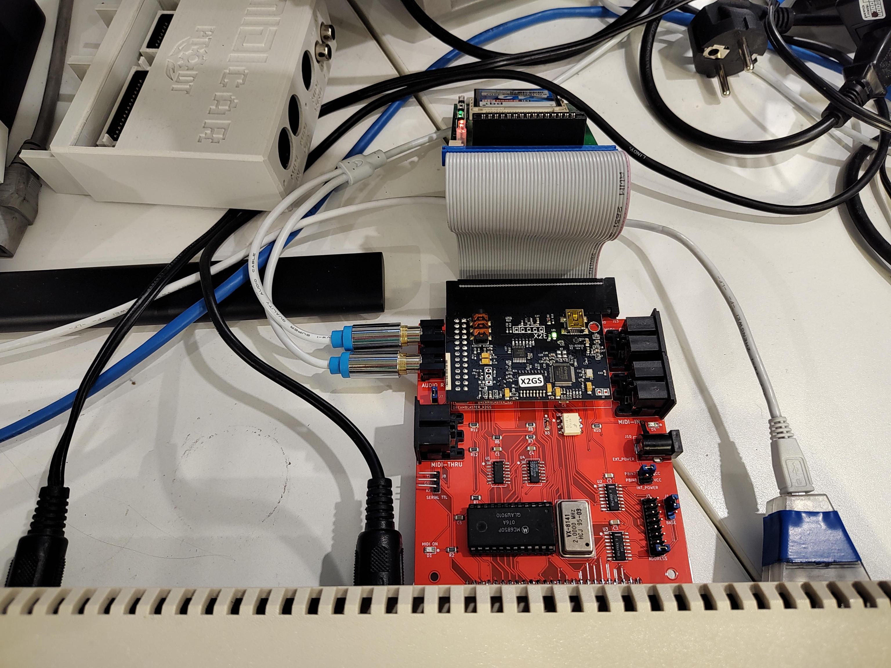

Maybe this is stupid idea but I'll write it anyway:
Why don't you split MIDIcar into two boards?
Board one is a simple "port extender".

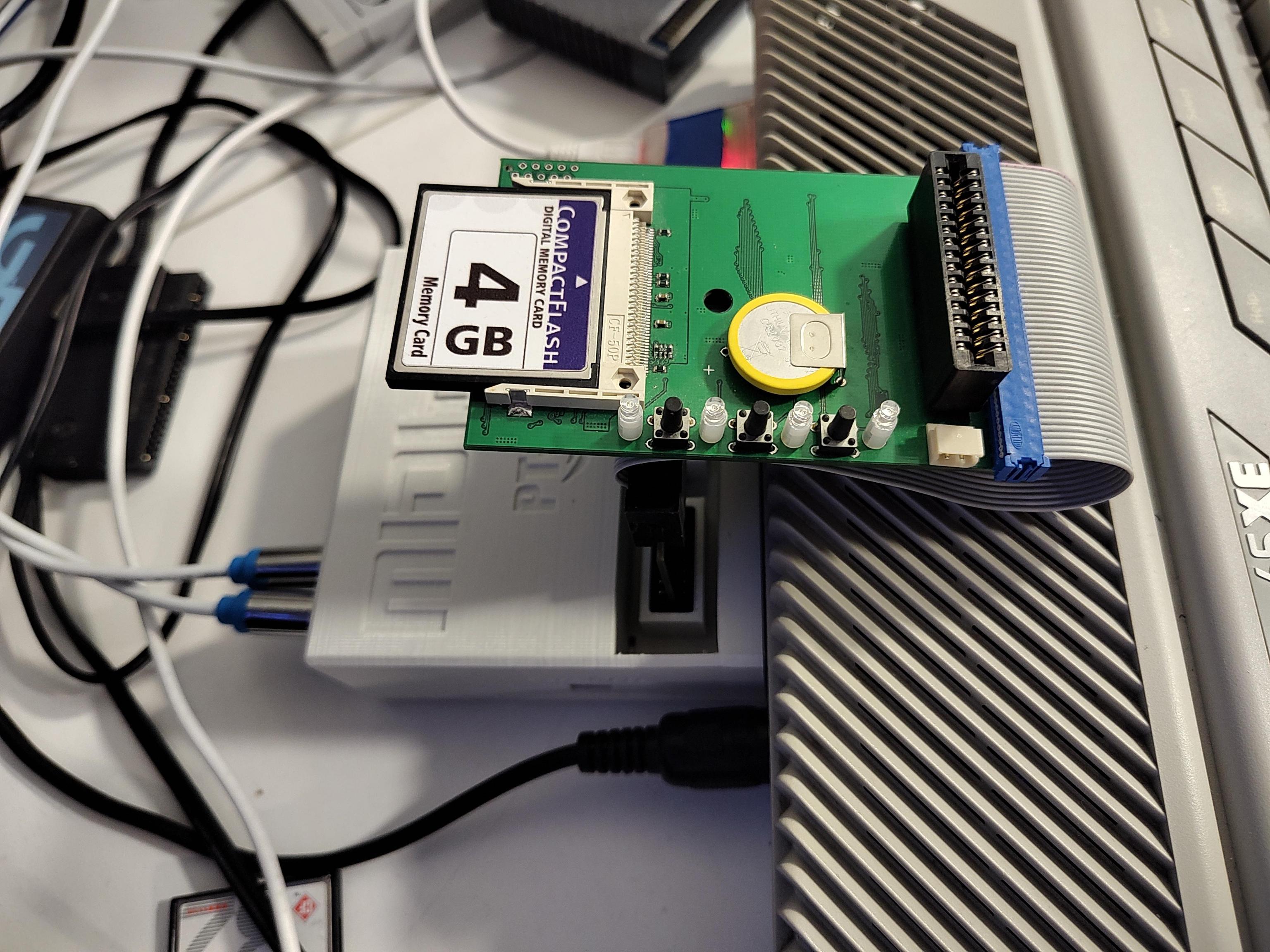

You can create two versions of a short board which plugs either into the PBI or ECI and has a matching PBI or ECI connector on the other end.
In the center of the board is a pin header which is connected to the bus and contains all signals of PBI/ECI.
You could perhaps add a cartdrige port as well so XE-users do not need to unplug the extender all the time (and have their carts plugged in vertically).
Board two is the MIDIcar.
It has a female pin header on its side and plugs vertically into the port extender.
This also solves the problem that the Atari with current MIDIcar design plugged in will become very deep.
The port extender also opens up the possibility to plug in other devices you or somebody else designs in the future.

When I used my BlackBox, most of the time I didn't plug the BlackBox directly into the computer. For some reason, I moved the computer around a bit, but because the BlackBox didn't move along, that would move the connectors relative to each other. So what I did was use the MIO extender (which more or less is a cartridge and ECI to PBI adaptor, made by ICD, with an extra cartridge port) and the ribbon cable CSS (the guys that made the BlackBox) intended to connect a BlackBox to an 800XL. That way I had a flexible connection between the XE and the BlackBox. XE - MIO extender- Flat/Ribbon cable - BlackBox.
Djaybee's solution seems to be a better solution as long as the vertical board isn't too large. But if it does, you might want to consider using an extender board that enables the user to use one or two devices via flat/ribbon cable.
Sincerely

Both ideas are very interesting. Now I'm considering to use short PCB with pass-thru adapter + 50 PINs IDC socket for flexible ribbon cable and other IDC sockets on MIDIcar end (like SCSI connections). Only one doubt... how long ribbon cable may I use to avoid ghosts and noises on the signal lines?

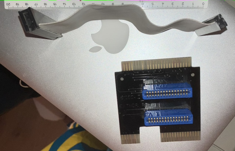

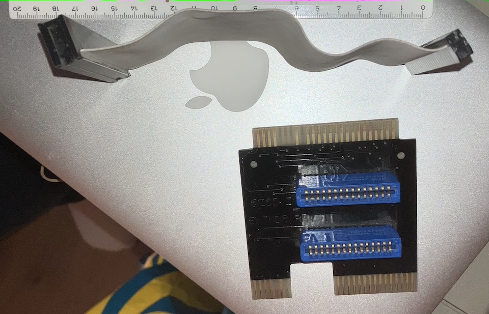

Hello Pancio
pancio hat geschrieben:
01.05.2022 00:54
I can't not tell you, but here's a picture of the MIO Extender and the flat cable that came with the BlackBox.
Sincerely

That's good think!
Is this documented somewhere or should I arrange this board from the scratch? Probably I should because it's little big and without IDC but I'm asking rather about connections (it's one to one or with some additional parts/crosses on the PCB). Very cool idea.
Sincerely,
pancio

Beiträge: 258
Registriert: 17.08.2021 11:03
Wohnort: Salzburg, Austria
Has thanked: 25 times
Been thanked: 167 times
Re: MIDIcar – independent, easy to use MIDI player/recorder
Beitrag von HiassofT »
Feel free to reuse the adapter boards we created for the Turbo Freezer 2011. Design files in eagle format are here:
https://www.horus.com/~hias/freezer/tur ... -files.zip

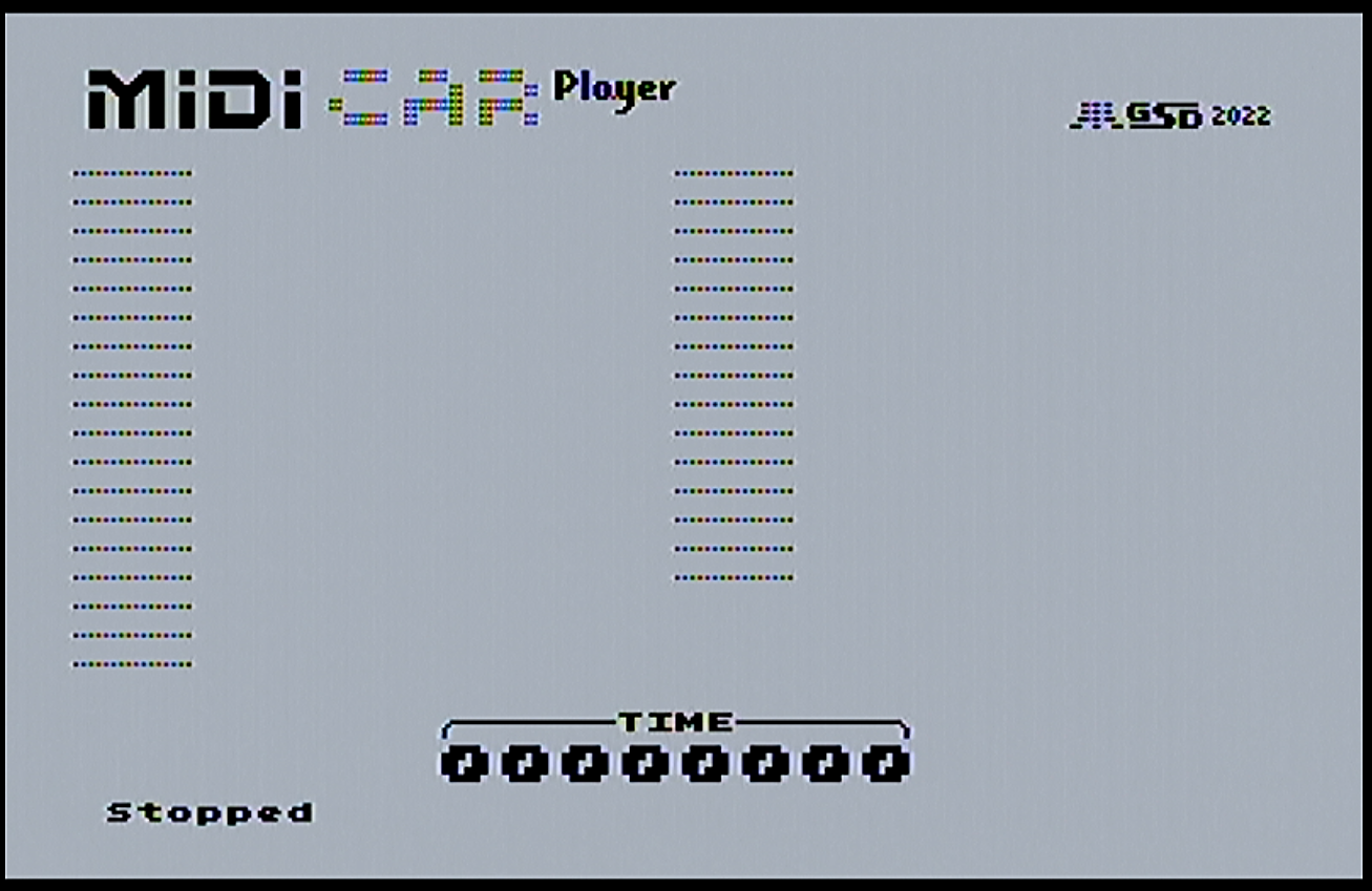

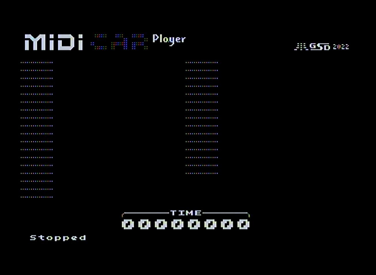

... but in mid time... PeBe made Player:
https://youtu.be/WFJyBG27bxg
https://youtu.be/zaZjuhLNJ2A
Regards,
pancio

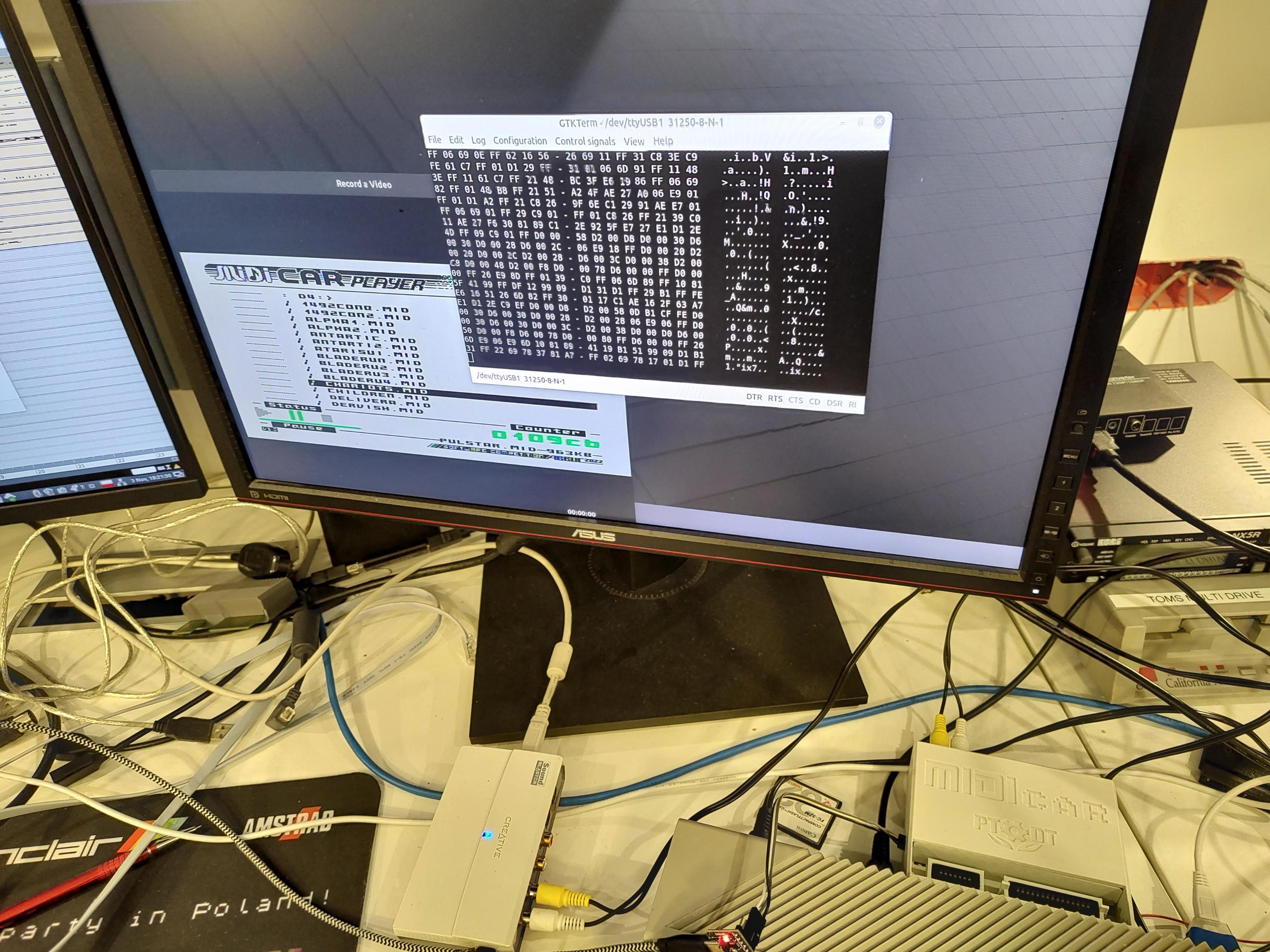

Beitrag von pancio »
Some other examples with newest PeBe's player:
https://youtu.be/qR9-LIQzzs4
https://youtu.be/A3Tuogv8Hg4
Now player can play MIDIs bigger than 42KB... the limit is 1MB.

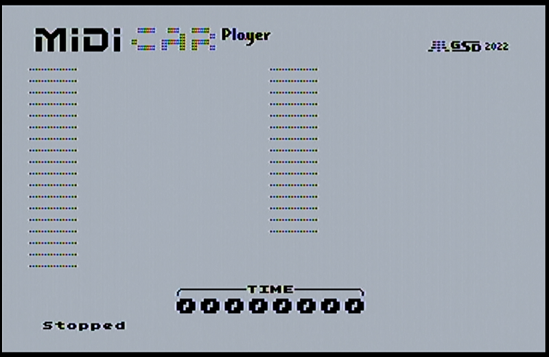

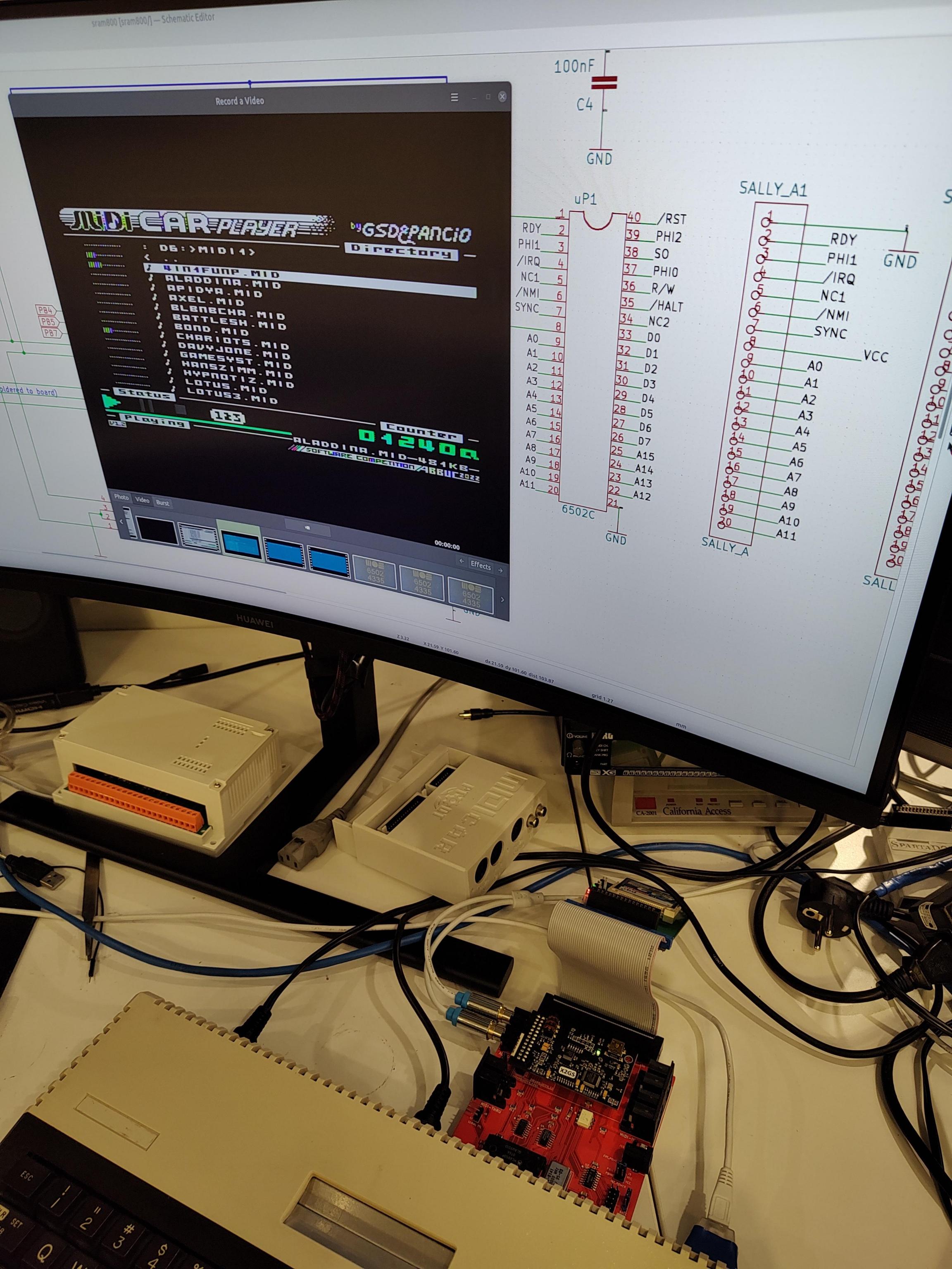

Hi All!
Milestone reached! Player form PeBe can play more advanced (not all) MIDI files.
Alpha1 (Vangelis) MIDI on Atari8 by MIDIcar and DreamBlaster S2 Sound Module
Alpha1 (Vangelis) MIDI on Atari8 by MIDIcar and and KORG NX5R
work in progress...

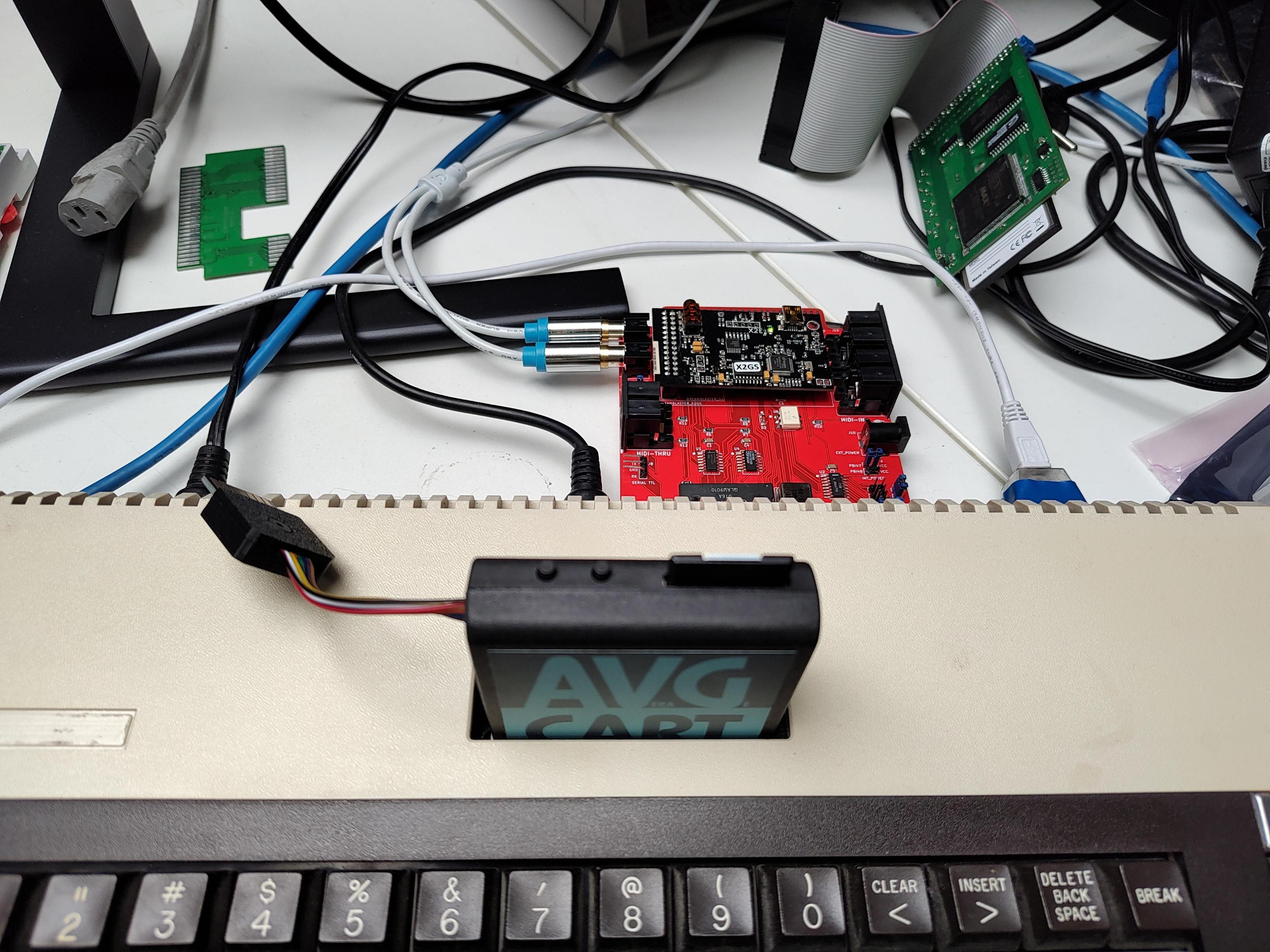

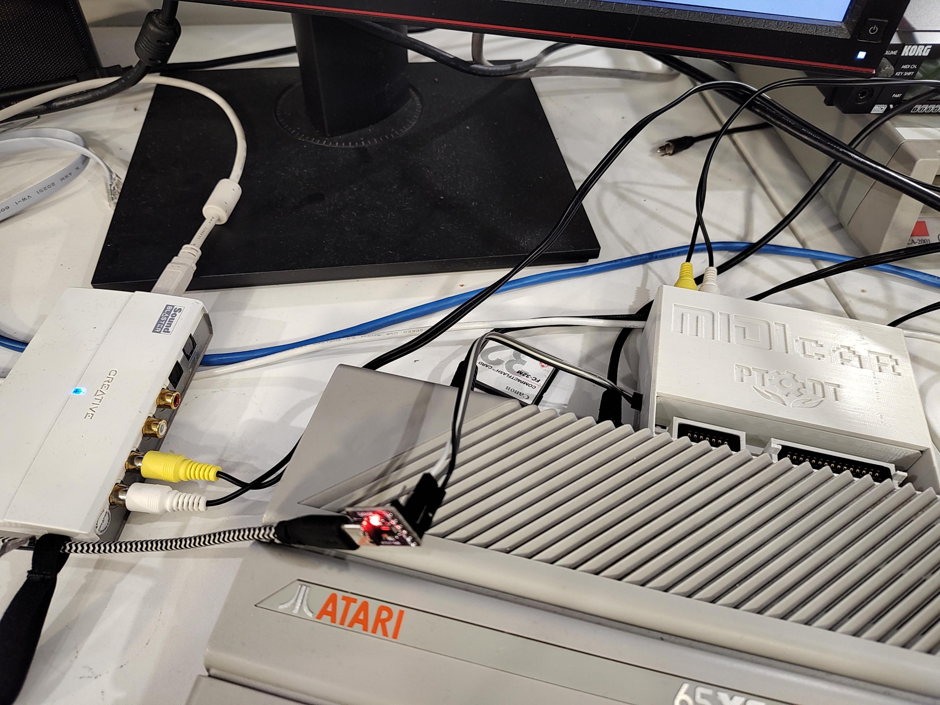

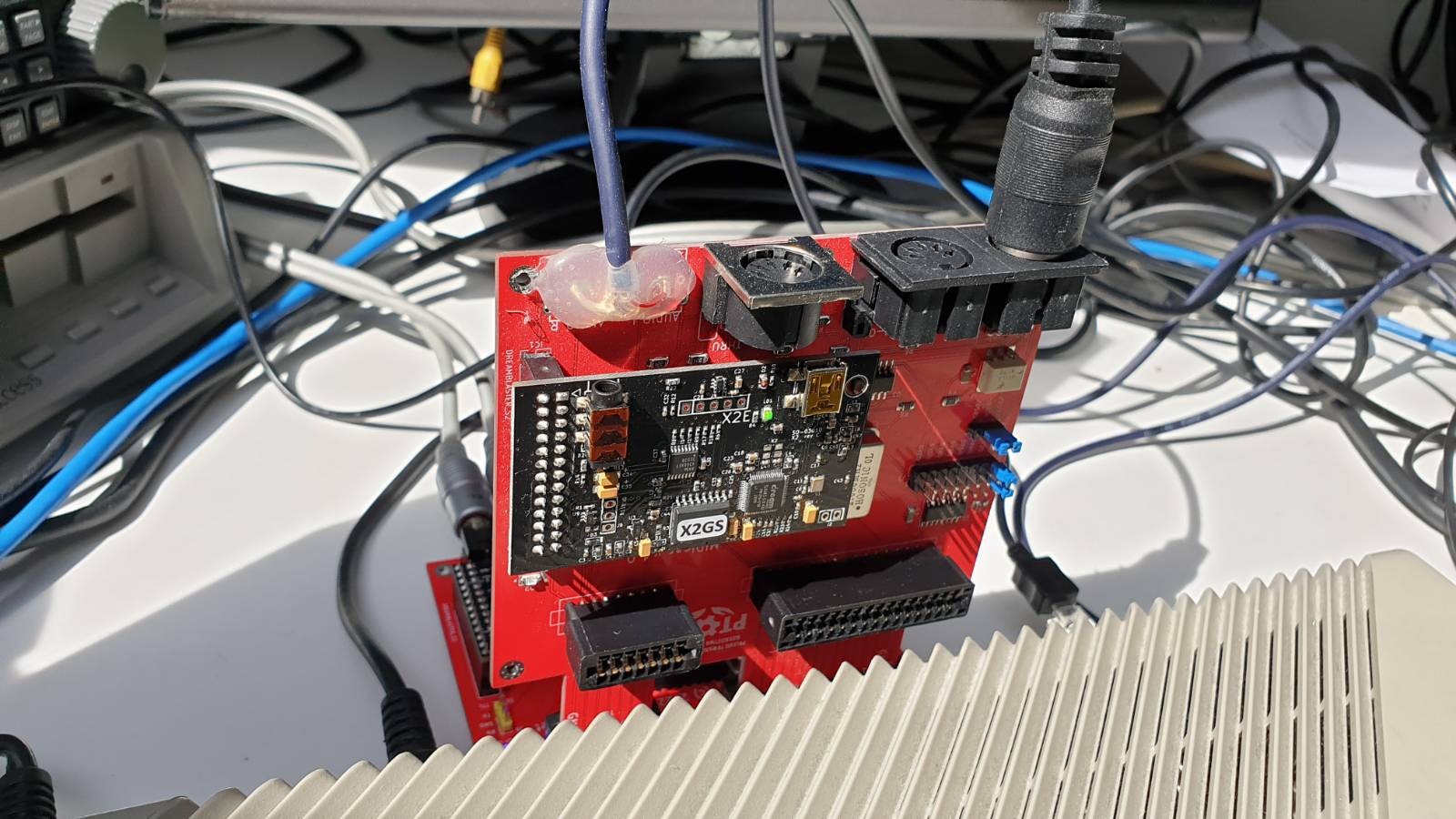

Just a few news from my desk...
Version 1.0.1 based on CART/ECI was finished (better quality, good RCA sockets).
Just for fun I stocked two MIDIcar and try to play on both in the same time :-)
And they playing together :-)
signal-2022-07-03-145752.mp4
(19.24 MiB) 1020-mal heruntergeladen
Next step... finishing XL version...

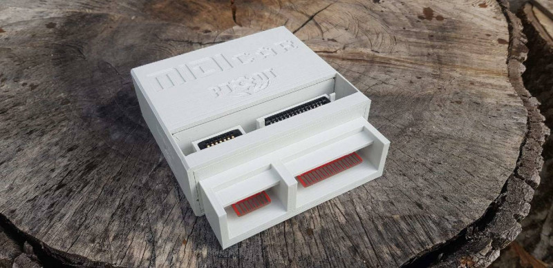

Hi Guys,

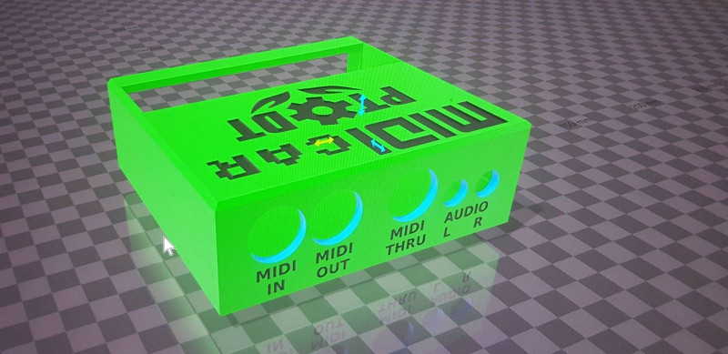

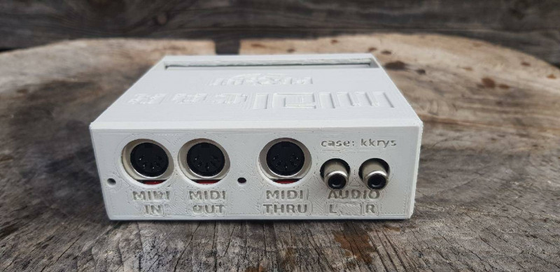

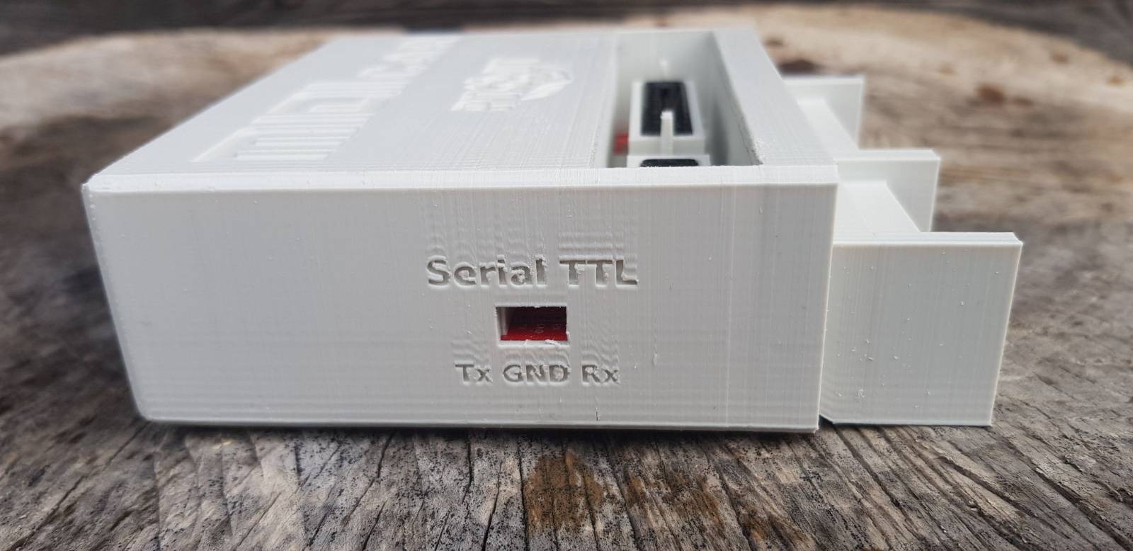

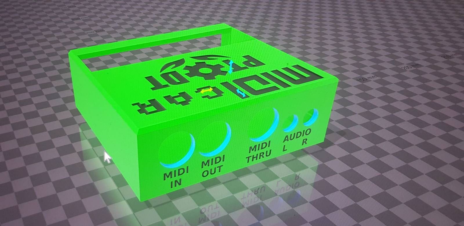

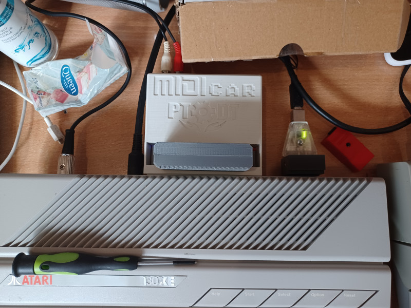

Our friend Kkrys made prototype case for MIDIcar. Someone of Atari users might see it on Lost Party 2022 (Licheń Stary, Poland). Of course, this is only prototype... we will plan to design a few models available with other colors variants too :-) The third photo shown that it's possible use MIDIcar with external memory expansion (512kb in case) so you don't need to modify stock Atari to enjoy most midi files :-)
Regards,
pancio

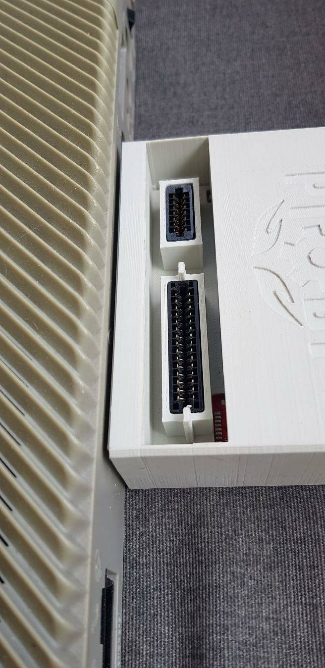

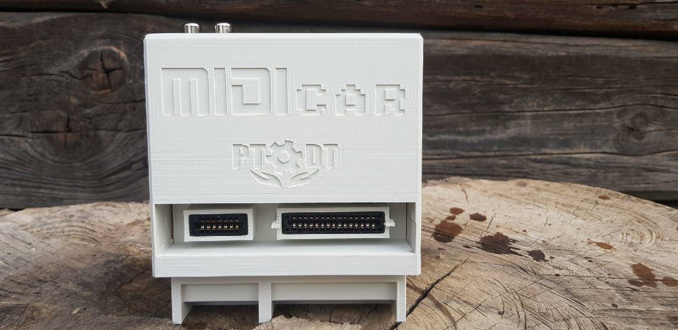

Anyone friend is willing to help to develop... I'll give rest from of development PCSs for free after ABBUC competition. So be in touch :-)
last case (hot print):
pancio

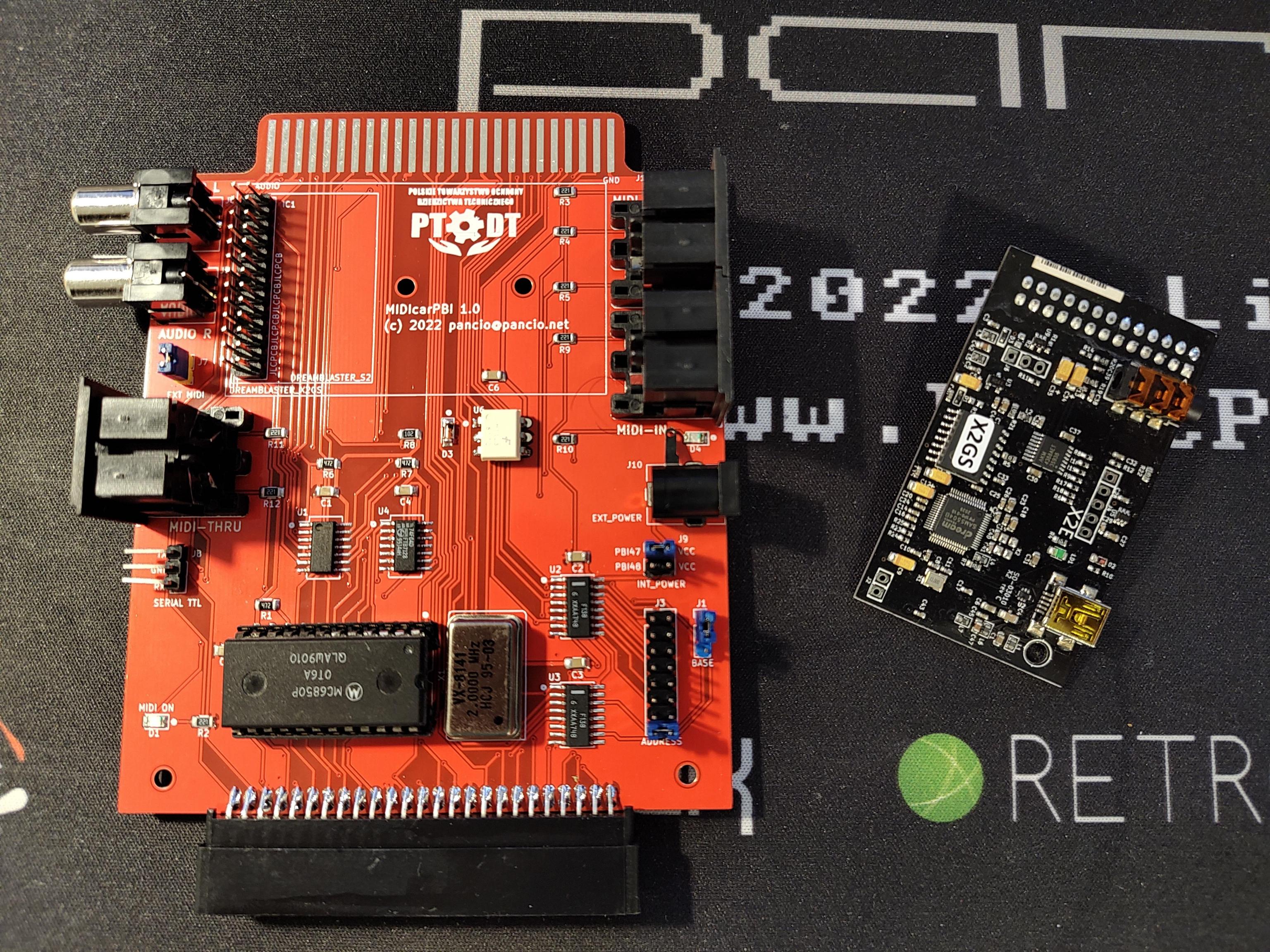

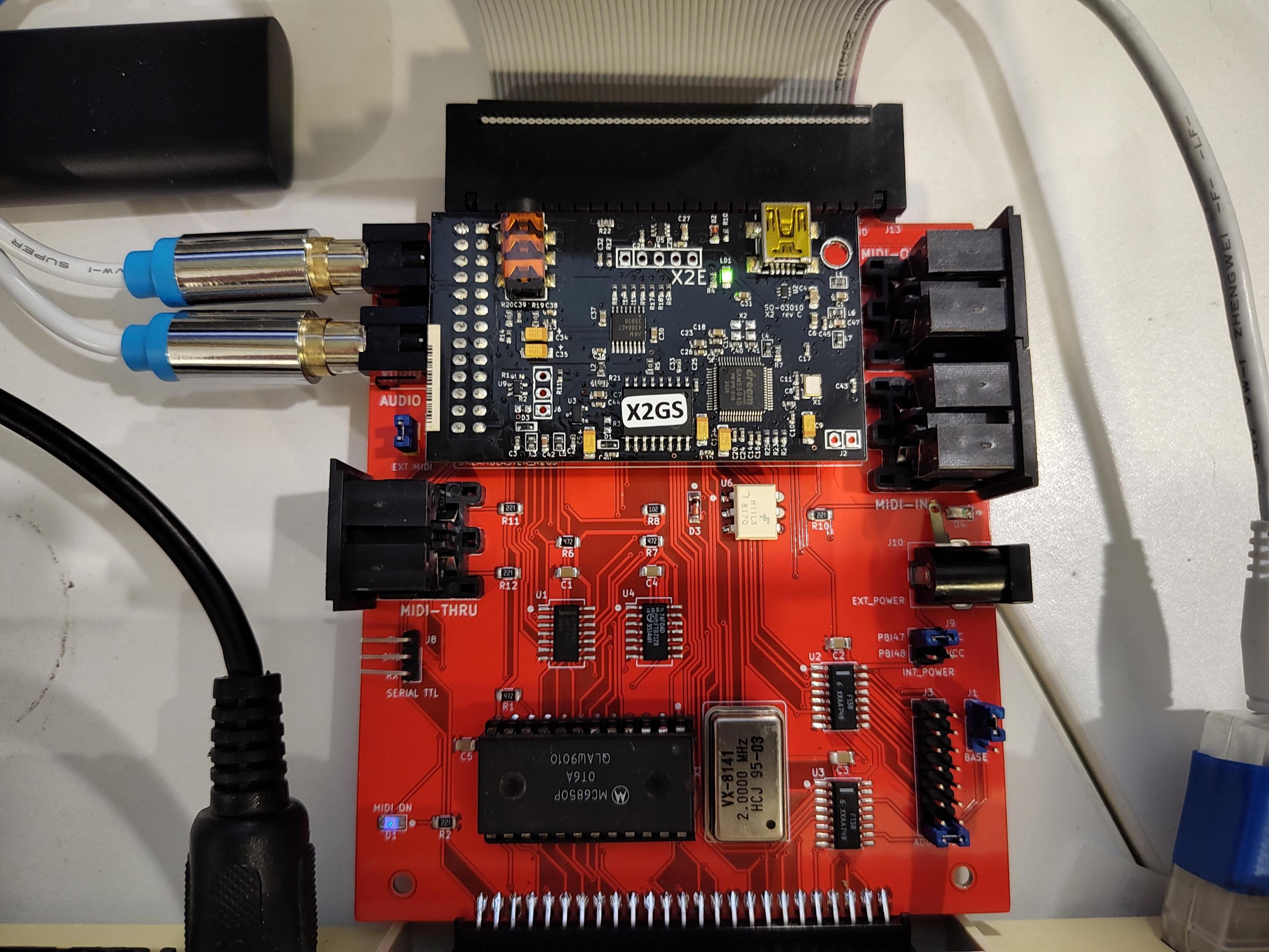

Has thanked: 304 times
Been thanked: 307 times

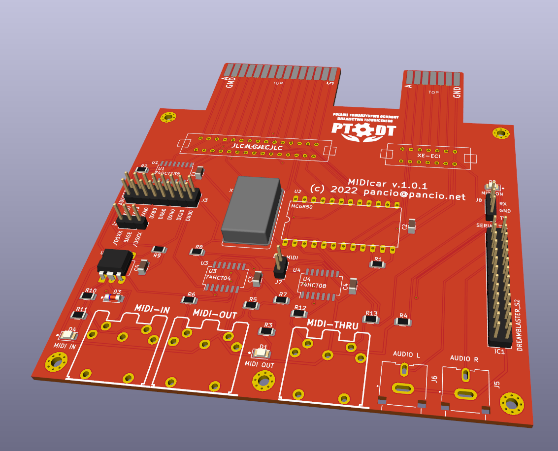

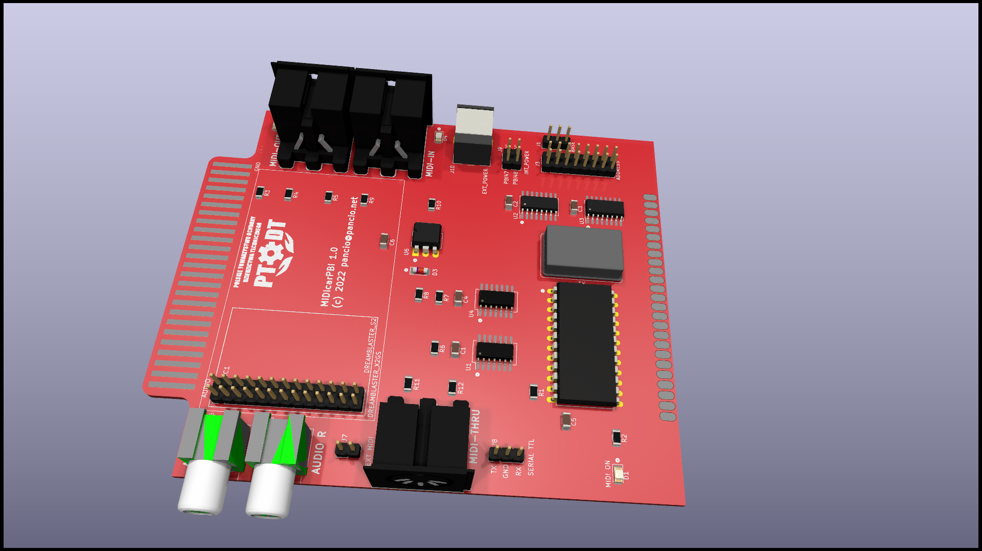

Hello Friends!
I pretty finished MIDIcarPBI version. I'm not sure the pass-thru PBI slot will work OK but we will see. If anyone has notices or comments, please let me know. I plan to send this to production this week :-)
PCB dimension: 120x100mm. On the bottom we will have 50pin PBI connector (I haven't 3Dshape for it!)

A few renders - just for fun (or resin case in the future):
revision 1.0.3 will be equipped with TTL<>USB-C converter based on CH340E for high speed serial...
Looks really, really coooool :o 8-) !

MIDIcar SERIAL connector first usage:
midi-debug-via-serial.mp4
(27.85 MiB) 1005-mal heruntergeladen
used as debugger for MIDI data.. but the most probably feature is very high transfer (theoretically 2Mb/s) It might be good alternative for SIO2PC...

Hello again!
Good news... now MIDIcar can play music directly form IDE+ or compatible interface under SpartaDosX :-) This is huge milestone! Now comfortable is on high level... loading time is very short (a few seconds)!
I found one bug on PCB... which was responsible for unexpected behavior with IDE+... modification on the existing PCB is very easy.. just push up 5th pin of MC6850 (/RTS signal)
https://youtu.be/h5Pq4HO0sL0

Hello Friends!
I know... so much time... but it was happened :-) MIDIcar for XL computers :-) It's very stable and working without any issue with IDE+ under SpartaDosX...
Enjoy!
pancio
https://systemembedded.eu
PTODT / A.B.B.U.C. Member
Beiträge: 2014
Has thanked: 1003 times
Been thanked: 616 times
Hello Pancio
Just this weekend I was thinking that we hadn't heard from you in a while.
The MIDI Thru port is very close to the video cable. Won't that cause any problems if somebody tries to use plug a cable into the MIDI Thru port?
BTW have you tried to plug one MIDIcarXL into the back of another? And a third into the second? :mrgreen:
Sincerely
pancio
Beiträge: 318
Registriert: 31.08.2021 07:31
Hi Mathy,
Yes... sorry I know - hobby is very important but family too :-) The reason why XL version was made is that I don't know when I'll finish common model for both XL/XE with additional middle board as we discussed in other very good topic: viewtopic.php?f=3&t=1035
So, gerbers and full project files is available on my page - anyone is willing to do it by himself. I'm not sure, XL version will be made by us and available in shop. I may prepare three modules because have a free PCBs from prototyping process. If anyone is interested in - let me know privately.
According to MIDI ports positions... well it's compromise between PCB length and usability... there is no issue with connecting passthru cable but it's looking little bit strange :-)
not yet... because I've only one MCpbi assembled at this moment. Will try, be sure :-)

Hello all,
Thanks Marius for interesting with MIDIcar.and thanks andY for your support and involvement... I'm sorry for this situation. I'm not able to make more than a few pieces because of lack of time. I will help with technical knowledge if someone decided to build his own piece or pieces for others. There is no limitation and no restriction for MIDIcar. I'm willing to spend time with new projects rather than assembly more pieces.. but I may promise, 10-15 MC will be made by my colleague Kkrys and will available on the market early January. I hope!
Little announce according MCplayer:
https://www.youtube.com/watch?v=95PjqzHXih0
Just one more notice... MIDIcar PBI version is capable to play with SIDE2, IDE+ or AVGcart together! :-)
