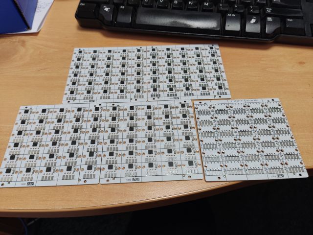

Re: ATARI USB-Mouse Adapter für alle ST/STE/TT/Falcon (Update: auch XL/XE)
Features :
- bootloader, for easy firmware upgrades via USB mass storage
- Uses HID for mouse/joystick -> more supported (hopefully), and access to all buttons/wheel/axis/hat
- USB buttons mapping to any LMB/MMB/RMB
- Autofire : mapping/frequency configurable
- RGB Led feedback : color/brightness configurable
- Debug info : via UART or (limited size) buffer dump to USB storage
- Planned : wheel mouse for Amiga, PS/2 mode via adapter on DB9, open-collector/push-pull individual pin config on DB9.
Specifically for XL, I hope that the push/pull mode will work, and thus no resistor patch needed on pin 9...
Previews :
Features :
Previews :

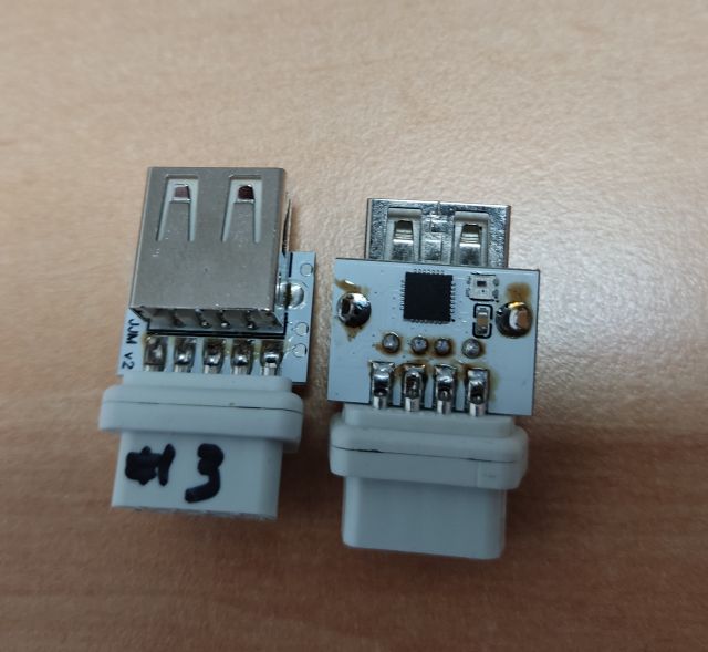

- andymanone
- Beiträge: 4672
- Wohnort: Berlin - Suburban
- Has thanked: 1239 times
- Been thanked: 2066 times
Mein Vorab-Prototyp ist heute per Post eingetroffen, Danke JJ
Wenn zeitlich alles klappt, setze ich mich am Wochenende gleich mal zum Testen ran
My pre-prototype arrived in the mail today, thanks JJ!
If everything works out in time, I'll get down to testing it at the weekend
