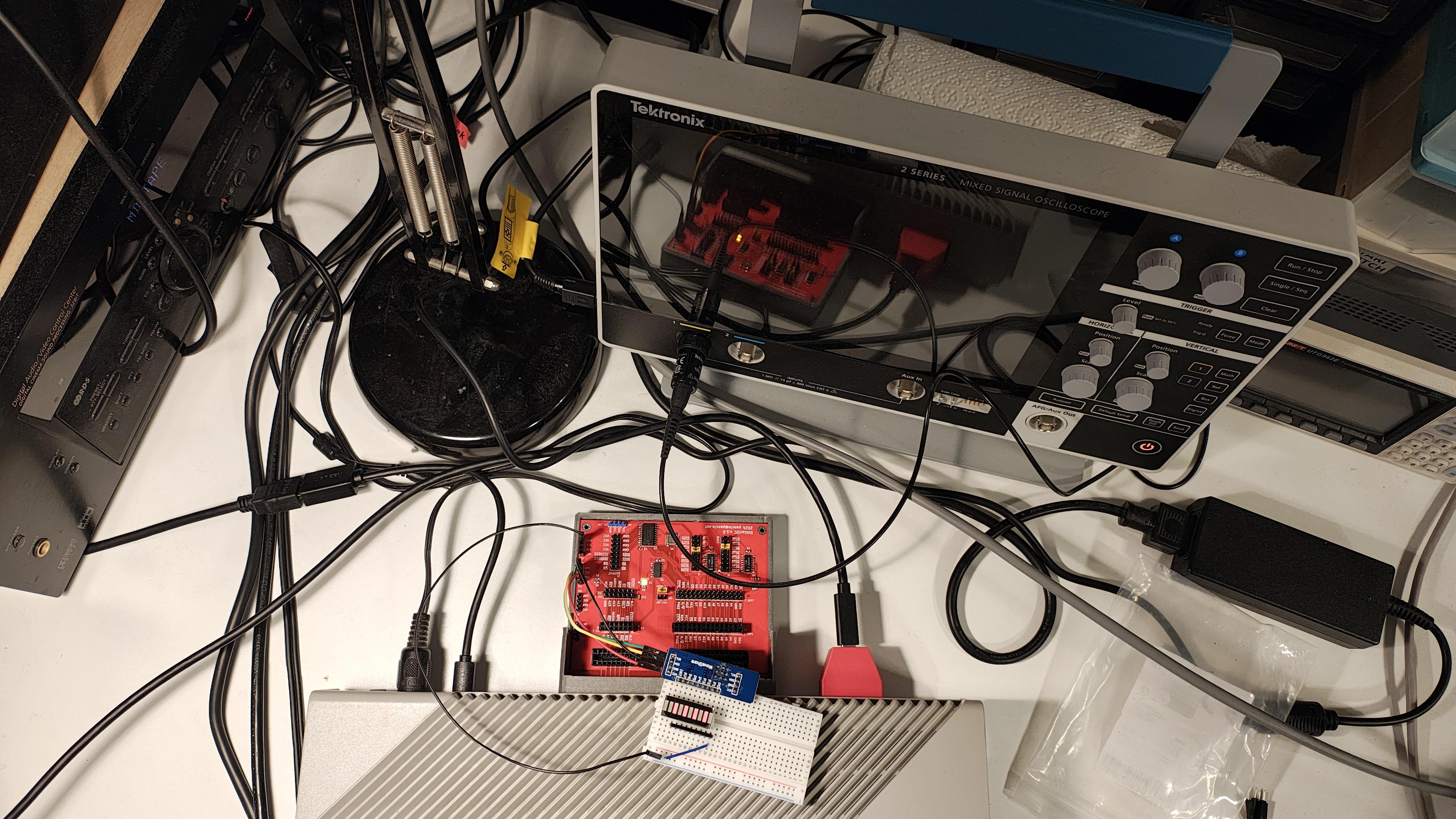

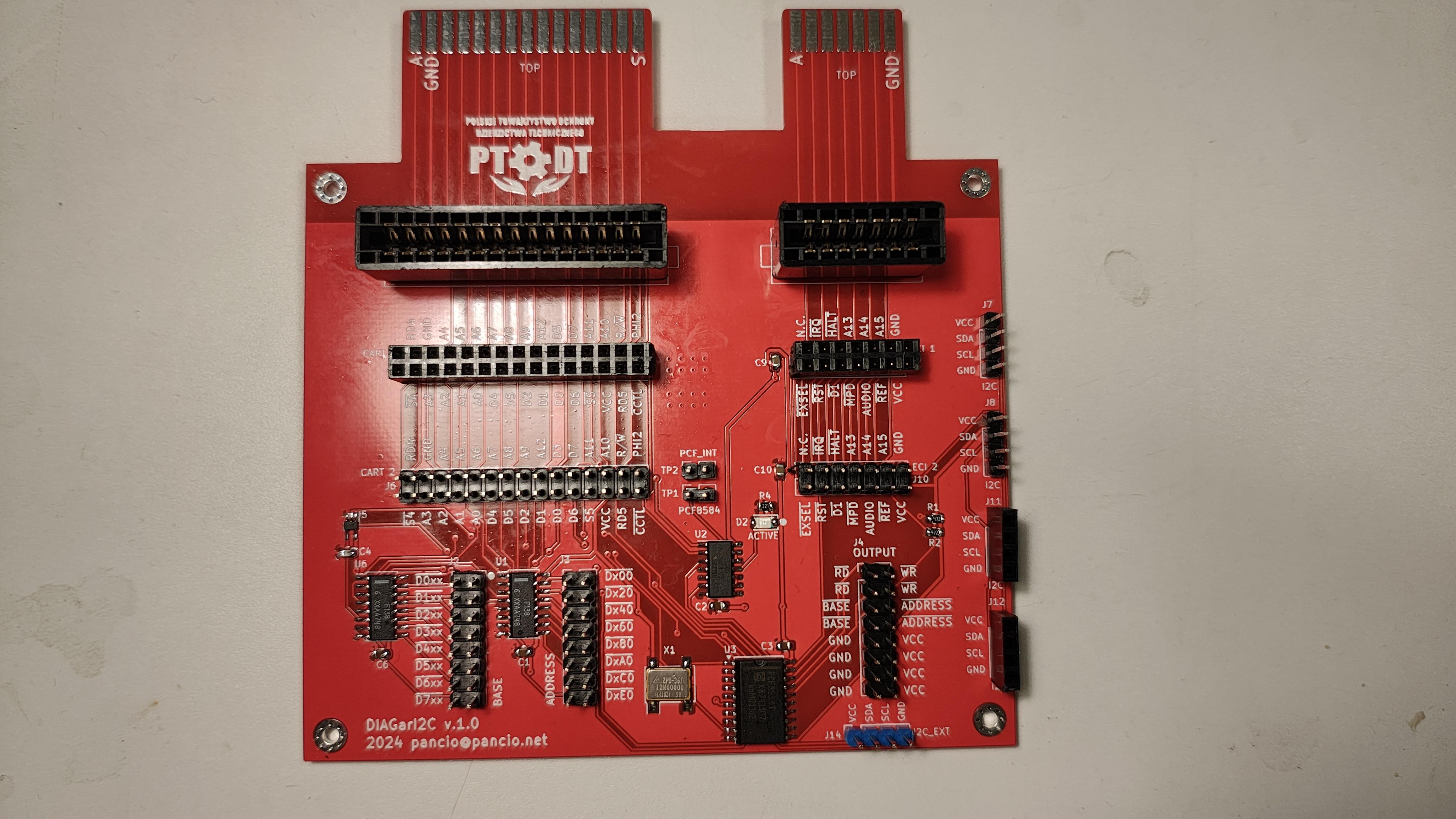

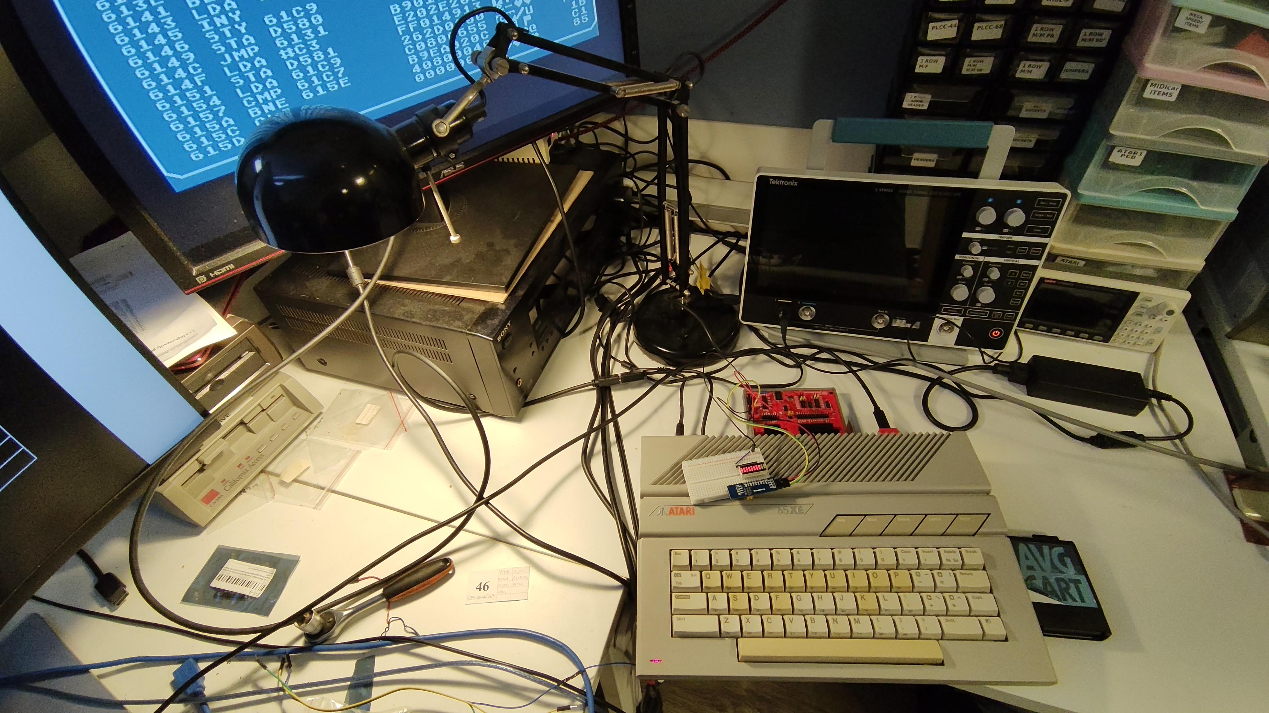

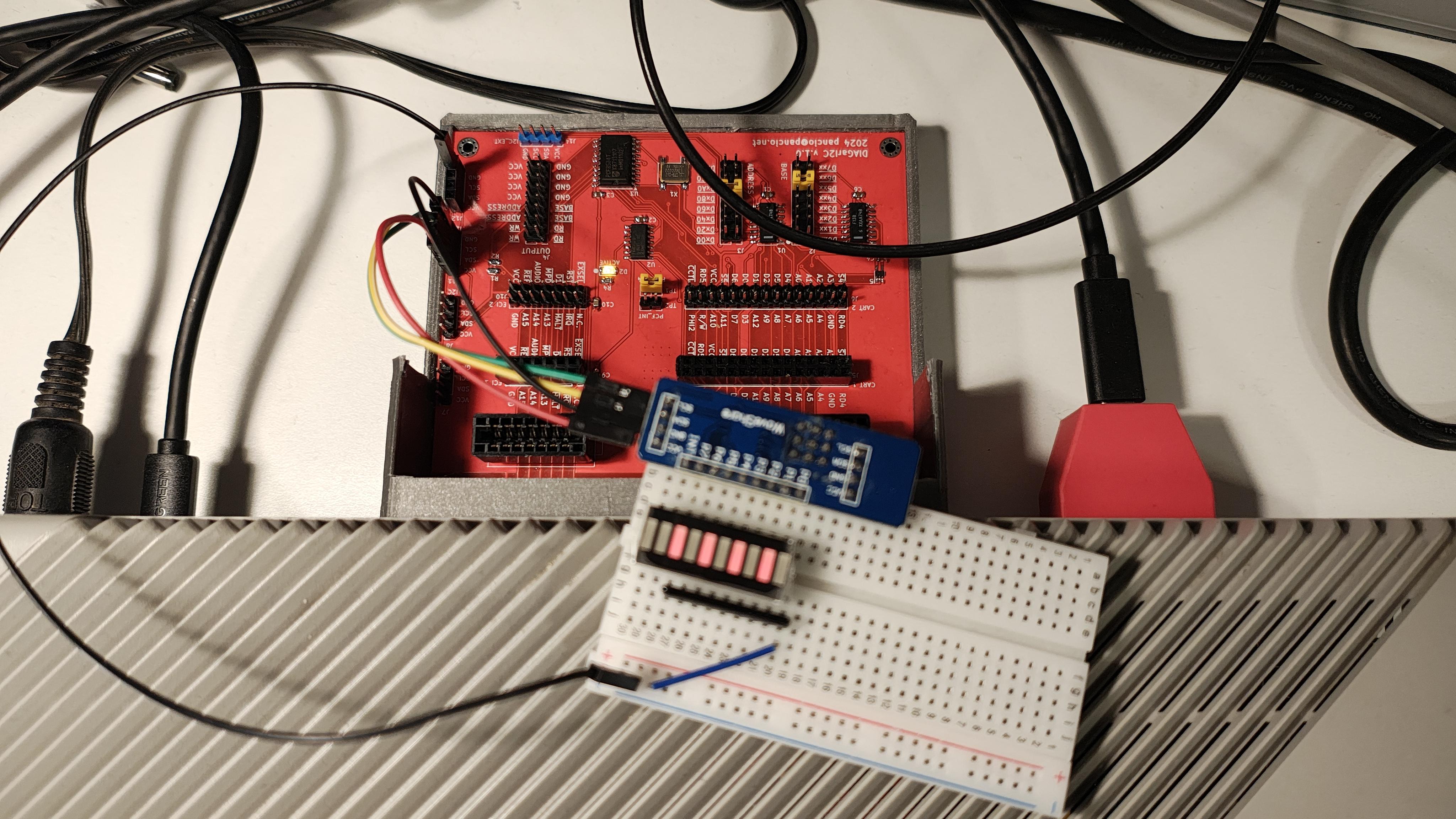

Today I want to introduce my new tool which can communicate Atari with many I2C equipped devices. It's very simply interface contains special IC made by Philips in 90' PCF8584 connected directly to Atari bus. No all features works as expected at this moment but simple communication with e.g. PCF8574A(I/O expander) is possible and we can send and receive data. I wrote short library in MASM to communicate with PCF8584 but it still need some tweaks. Project will be available on my page with a few examples 🙂
I hope, someone will use Atari like Arduino 🙂
If anyone is interested to use/test/develop library I may send PCB :-)

A very good idea! But, IMHO - it would be great to make V2 before this one really comes to market 8-)
Why? Having I2C directly controlled from the Atari is cool, but due to the passive integration you can only use it with assembly language.
My suggestion: Think about a PBI device with PBI handler ("I:" for example) and make it usable using some simple commands for every language like Basic or Turbo-Basic or whatever. THIS would be a really great thing, when hobbyist programmers can easily connect one or more I2C devices (temperature sensors, pressure detection, hundreds of more cool sensors, actuators and more).
The main problem of such expansions (see USB cartridge...) is the needed skills in assembly language. Most users won´t marry the machine, they want to have fun with fast success.
Just my 2 cents....
