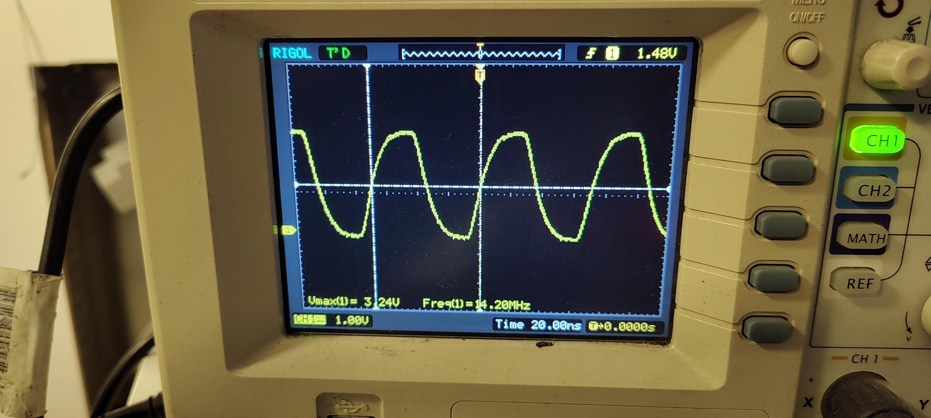

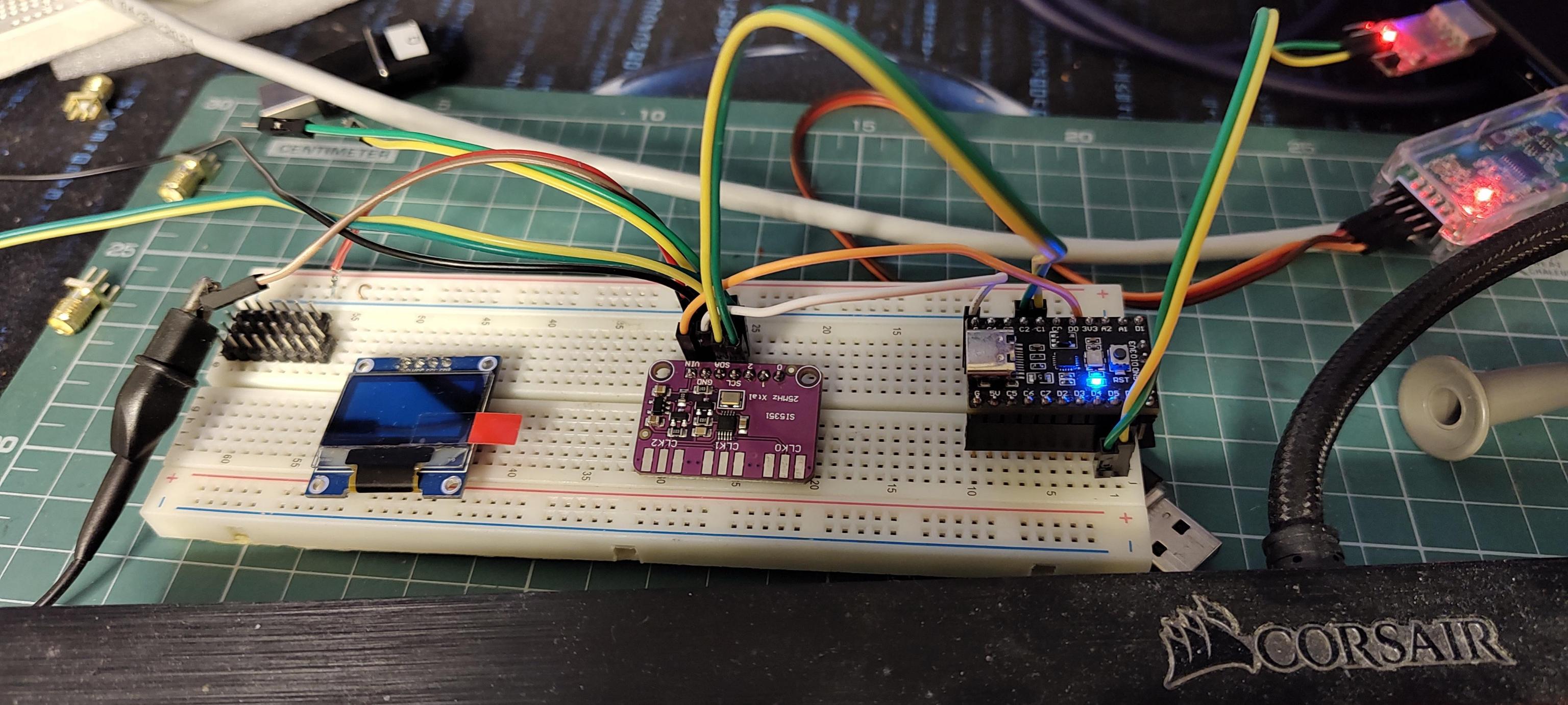

So I thought that if the main XTAL for Atari is not available - 14.187570MHz crystals, one of several programmable VCXO generators could be used.
I did preliminary tests with SI5351 and they are very promising... the question is whether there is a need for such a project... This system can replace all XTAl at once...
