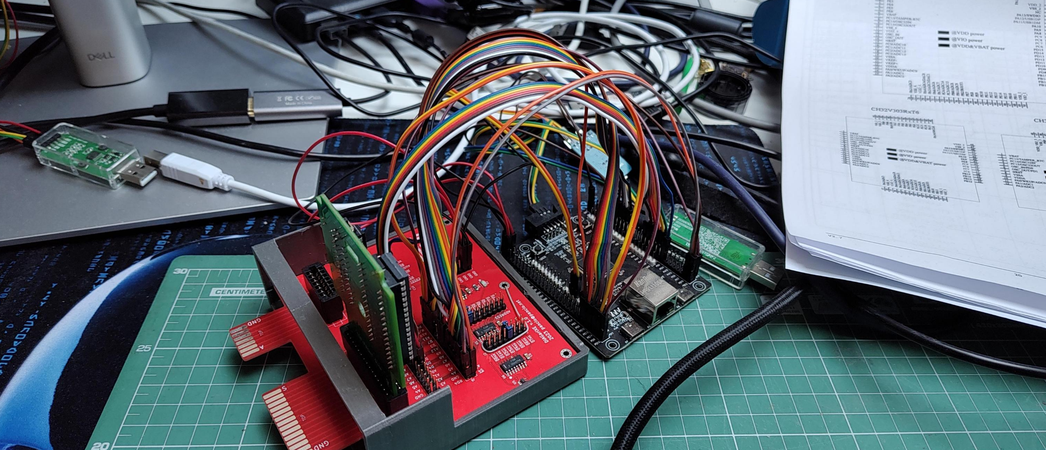

I am currently working on a project that will allow for quick CART recording. Reading works at the level of 512KB in 5 seconds! I can't provide implementation details yet, but my runtime looks like this:
So it's possible that The Cart! will be written and read very quickly. Unfortunately JAC! doesn't respond to me and I don't know the cart's memory structure to be able to implement it...

I'm not sure... The idea is to use mscIDE as is (without firmware modification) and connect to SSD/NVMe/FLASHDISK/SD device using IDE2SATA or IDE2NVME interface. At this moment we don't know it's possible but if mezzanine interfaces are full compatible with IDE standard - it should be possible to have access to each drive.
So, from Atari point of view - software will see IDE only. I hope it will work :-)
