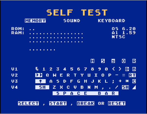

Brian hat heute v6.20 veröffentlicht.
https://forums.atariage.com/topic/34769 ... nt=5526580
Change log going back to Atari's OS 3
;* Revision 3 (65XE/130XE)
;* Fix initializing of CHKSUM.
;* R. K. Nordin 03/23/84
;* Update self-test for 130XE keyboard and RAM.
;* Revision 6.00
;* Merged from Revision 3 (600XL/800XL/1450XLD)
;* Fix MAXDEV, problems resulting from CRASS65 version,
;* initial address for RAM sizing, "Boot Error" message,
;* initial address for cartridge equivalence checksum,
;* mishandling of SIO NAK, and initializing of CHKSUM.
;* R. K. Nordin 03/27/84
;* Merged from Revision 3, Version 2 (600XL/800XL/1450XLD)
;* Dedicate PDVI ($D1FF) to external parallel device IRQ status
;* Dedicate IPDVI ($D1CF) to internal parallel device IRQ status
;* Using PDIMSK ($0249) for external parallel device IRQ selection mask
;* Using IPDIMK ($0254) for internal parallel device IRQ selection mask
;* After masking (PDVI, PDIMSK) & (IPDVI, IPDIMK), OR the result
;* together, prior to processing parallel device IRQ
;* On cold start, initialize PDVI = 0, to avoid potential
;* checksum error.
;* Y. T. JANG, V. WU 02/22/84
;* Merged from Revision 3, Version 3 (600XL/800XL/1450XLD)
;* Dedicate the 11 bytes at ACMVAR ($3ED-$3F7) for use as
;* a RESET routine area. On warmstart, the OS will JSR
;* to ACMVAR immediately after initializing hardware.
;* MIKE BARALL 06/08/84
;* Merged from Revision 3, Version 4 (600XL/800XL/1450XLD)
;* Make CIO accept device number 0 (like Rev B did).
;* MIKE BARALL 06/21/84
;* Merged from Revision 4, Version 0 (600XL/800XL/1450XLD)
;* In PBK, change DEC BRKKEY to STA BRKKEY.
;* Add support for SIO fast mode (38400 baud).
;* Mike Barall 07/24/84
;* Merged from Revision 59 (Arabic 65XE)
;* Shift-Help toggles international character set.
;* Changes by Brian E. Reifsnyder (4/20/2023)
;* Shift-Control-Delete cold starts the computer.
;* Control-Help sets left screen margin to 0.
;* Processing of Control F1 through Control F4 no longer affects PORTB.
;* Left margin set to 0.
;* Reduced KRPDEL from 48 to 20 for NTSC and from 40 to 20 for PAL.
;* Reduced KEYREP from 6 to 4 for NTSC and from 5 to 4 for PAL.
;* Cleaned up and reorganized KIR.
;* Re-added F1-F4 keys to the keyboard self test.
;* Re-wrote the majority of the self test to conserve space.
;* Removed PUPBT1 to fix HATABS overlap of first power-up validation byte.
;* Added a built-in CX85 numeric keypad handler for joystick port 2.
;* Shift-Control-3 (#) to toggle on/off.
;* Atari BASIC version now displayed on self test screen.
;* Self test now displays which bit(s) failed the memory test.
;* Video type displayed on self test screen.
;* Patched with Fast Math F+ floating point package.
;* Revision 6.10
;* Moved Self-test, Part 3, into self-test bank.
;* ROM Checksum now only checked during self test.
;* Re-added power-up validation byte PUPBT1 at $026A
;* Reduced SIO command retries (CRETRY/CRETRI) to 4 to reduce boot time
;* Removed Shift-Help international character set toggle due to Highspeed SIO patch.
;* Removed support for SIO fast mode (38400 baud) -- Support was for non-released Atari drive.
;* Removed LNBUG compiler directives.
;* Removed RANSYS compiler directives.
;* Removed ACMI compiler directives.
;* Patched with Highspeed SIO patch V 1.33 (2023 version).
;* SHIFT-CONTROL-S Clears SIO speed table/enables highspeed SIO
;* SHIFT-CONTROL-N Disables highspeed SIO
;* SHIFT-CONTROL-H Enables highspeed SIO
;* Locations of SIO and KIR are now fixed so as to work properly with Highspeed SIO patch.
;* Clear self test screen RAM prior to use.
;* Boot with SELECT key down to disable Highspeed SIO.
;* Brian E. Reifsnyder (8/7/2023)
;* Revision 6.11
;* OS can now reside on a 1090XL/1091XL firmware board. (Under development)
;* A vector has been added at $FFEC to re-initiallize the OS by a
;* 1090XL/1091XL firmware board.
;* Added OSCFG1 and OSCFG2 bytes for OS configuration from non-volatile RAM.
;* Added PBICFG byte to support enable/disable of compatible PBI devices.
;* Brian E. Reifsnyder (11/23/2023)
;* Revision 6.19
;* Added The WOZ Monitor for the Apple 1
;* Written by Steve Wozniak in 1976
;* Ported to the Atari 8-Bit by Frederik Holst in 2022/23 for ABBUC Software Contest 2023
;* Enter from BASIC at $FFE9 using X=USR(65513)
;* Enter at any time using SHIFT-CONTROL-W
;* Brian E. Reifsnyder (12/2/2023)
;* Revision 6.20
;* Finished integration between OS and firmware board. (Works in emulation.)
;* Bug in CCR found by kenames99 on AA. Bug fix is to replace BCS with BCC.
;* Compatibility bugs with 1090 80 CVC found by kenames99 on AA. Bugs were fixed by BER.
;* WozMon now entered using SHIFT-CONTROL-INVERSE
;* Peripheral Handler Loading Facility can be compiled out by setting PHLF to FALSE.
;* Peripheral Handler Loading Facility is now compiled out.
;* SBR3 fix to save 2 bytes
;* FTX fix to save 2 bytes
;* SCB1 fix to save 1 byte
;* WCB fix to save 1 byte
;* Improved Cassette Handler: Reading RTCLOK+2 and VCOUNT, in SBR,
;* will now avoid VBI. Code "borrowed" from AltirraOS
;* Merged from Revision 10 (1200XL)
;* JMPERS scan added and still doesn't work right. (Currently disabled.)
;* Jumper 1, W1 on Atari system boards, now executes self test when removed. (Once JMPERS scan is fixed.)
;* Jumper 2, on 800XL remake board by BER, now disables the attract mode when removed. (Once JMPERS scan is fixed.)
;* The Altirra BASIC version is now displayed from Self Test screen when PHLF is not compiled in.
;* On a 16k system, the Self Test screen now only shows 1 row of dots for the memory test.
;* Brian E. Reifsnyder (1/2/2024)

Mathy hat geschrieben:
31.03.2023 01:59
... der Sound-Test unterstützt jetzt auch Stereo...
Bin mir nicht ganz sicher ob das stimmt. Ich habe probiert Brian zu überzeugen rechts von der Tastaturdarstellung noch V5 bis V8 hinzuzufügen, das hat aber nicht geklappt. Das Bild währe so auch schön symmetrisch gewesen...

Ich habe das OS6.20 ausprobiert und dachte erst, dass alles okay wäre. Aber mein Spiel Schränker 3 lässt sich nicht laden?
Bei OS6.19 funktioniert das Spiel.
Habe dann noch ein paar andere Test gemacht und glaube das es Probleme mit dem CIO-Funktionen gibt.
Mein Spiel stürzt ab, weil es den E:-Kanal (Editor) schließen möchte.
Ein andere Programm stürzt ab, als es einen S:-Kanal (Bildschirm) öffnen wollte.
Kann das jemand bestätigen?

Brian hat in den letzten Tagen nochmal daran herumgeschraubt, Bugs gefixt und vor allem irgendwelche internen Strukturen an deren Position vom XL-OS v2 gesetzt um die Kompatibilität zu erhöhen.
Probier's mit diser v6.40 mal, bevor du weitersuchst:
https://forums.atariage.com/topic/34769 ... nt=5532368

Danke, jedoch bekomme ich jetzt sofortige "Boot Error"-Meldungen, wenn ich mein Schränker 3 damit laden möchte.
Also zumindestens gibt es keinen Absturz :-)
