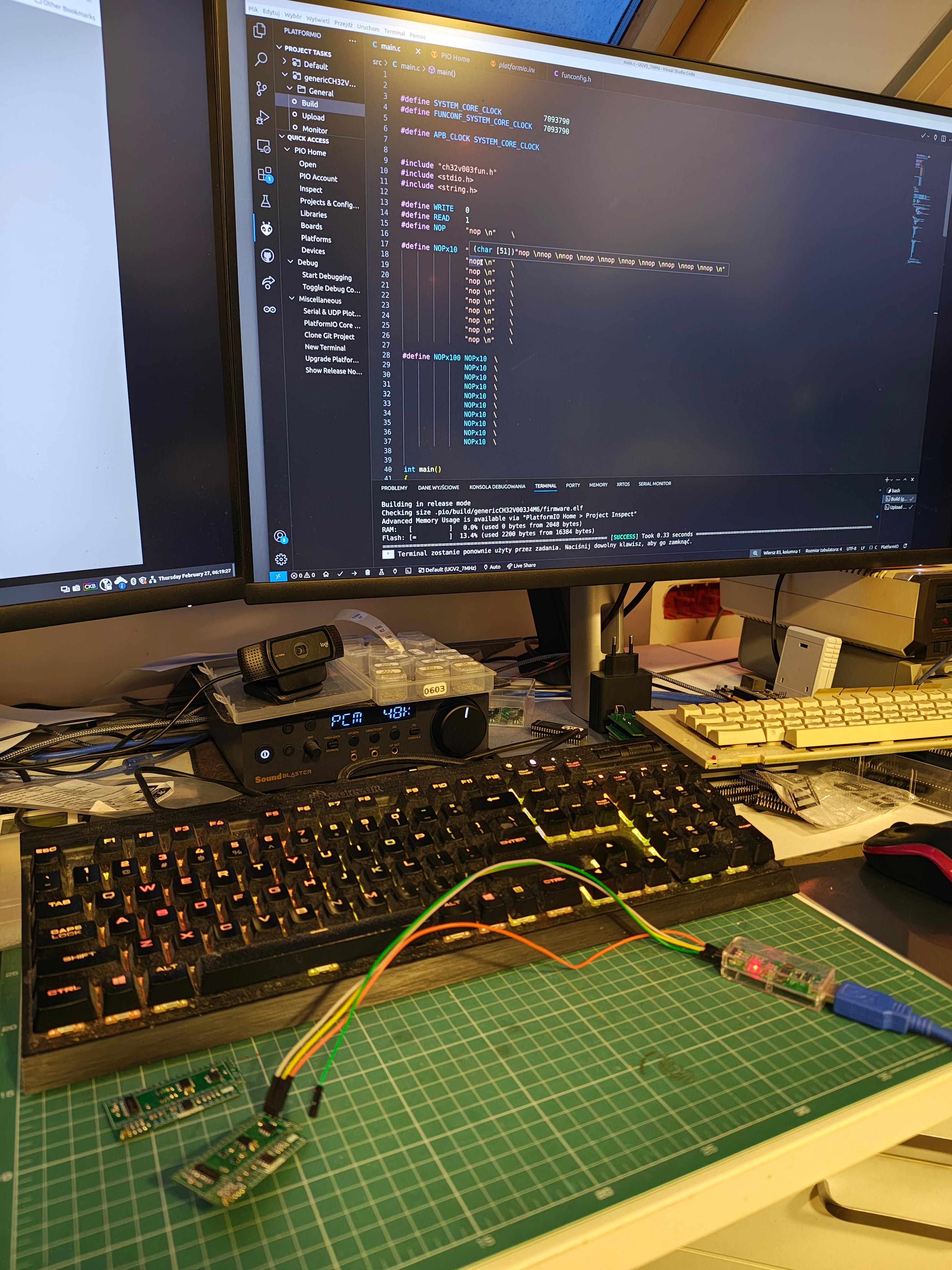

Programming is easy, just use CH32V003fun from github: https://github.com/cnlohr/ch32v003fun
If you want we may set short session in order to explain how to compile and flash image.

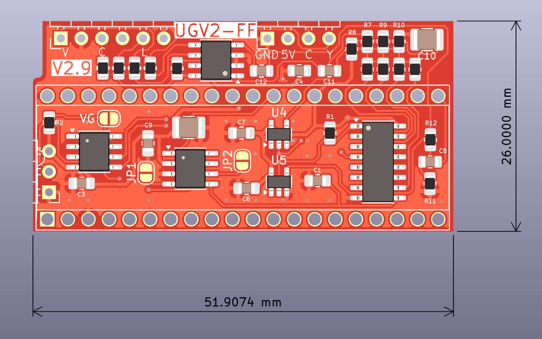

Yesterday I sent to production new boards v2.9 which is little bit smaller.. to fit Atari 1200XL with UGV2. There was not possible with existing v2.6:
So the new one PCB shall be ok:
I'll update you after tests. Of course this version will be available as well.
BR,

Nope, v2.6 is really good tested and working perfectly. Version 2.9 has added optional capacitor on Fout line (you may add it if needed) and i decided to change footprint for 74LVC1G07 to bigger one.

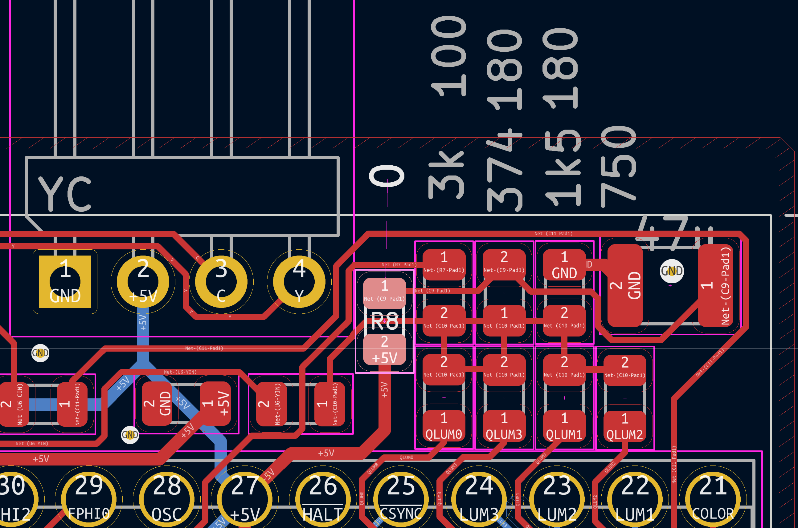

I have now taken a closer look at the circuit diagram and the component list and have two more questions.
  • Why is there a 0 Ohm (R8) resistor?
  • The two capacitors C1 and C9 are shown polarized on the circuit diagram. Can I also use simple unpolarized MLCC capacitors or do they have to be tantalum capacitors? I have not found any electrolytic capacitors with a 1210 footprint.

The R8 originally was set to 27ohm by Mytek but after some tests we decided to set it to 0ohm because of video signal level - maybe it was good for NTSC , I don;t know but for PAL system it's better in order to have full voltage level. I decided to leave this resistor's pads because somebody want to tweak video level, so if you want, you may use wire instead 0Ohm resistor.
You may use non-polarized capacitors. I'm using 1210 size 47uF. I tested UGV2 with 10uF capacitors - it's working good as well... on the beginning I used tantalum 1210 polarized capacitors but... these are not cheap and easy to damage e.g. because of overheating, so I changed these to standard MLCC.
There are no stupid questions... I made nine versions of UGV2 because I don't know everything when I start to build it :-), so don't be hesitate if you have ANY question.

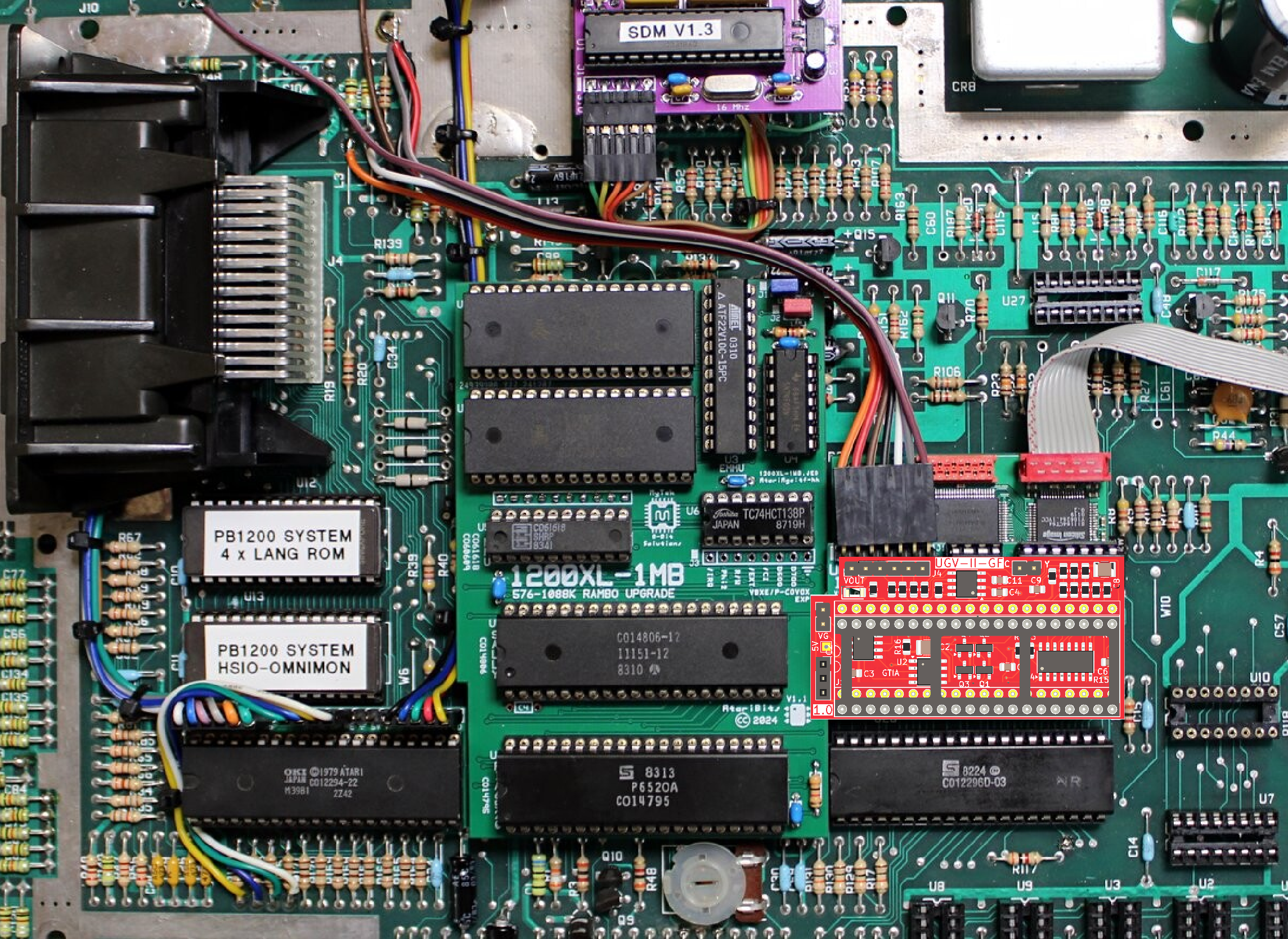

I'm not sure... but as I heard there is no place for additional piggy board inside A800. I haven't it to check. Maybe it's time to make something like SCCC2? :-)
BR,
pancio

For UGV, Michael recommends to remove the GTIA socket and solder the UGV directly into the CPU card.
Problem is the programming header, but I think, one can solder a ribbon cable directly in. On the other end, there needs to be a male Dupont connector for connecting the programmer.

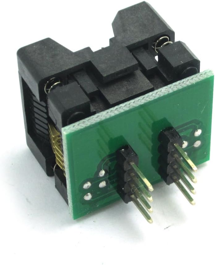

pancio hat geschrieben:
26.02.2025 14:45

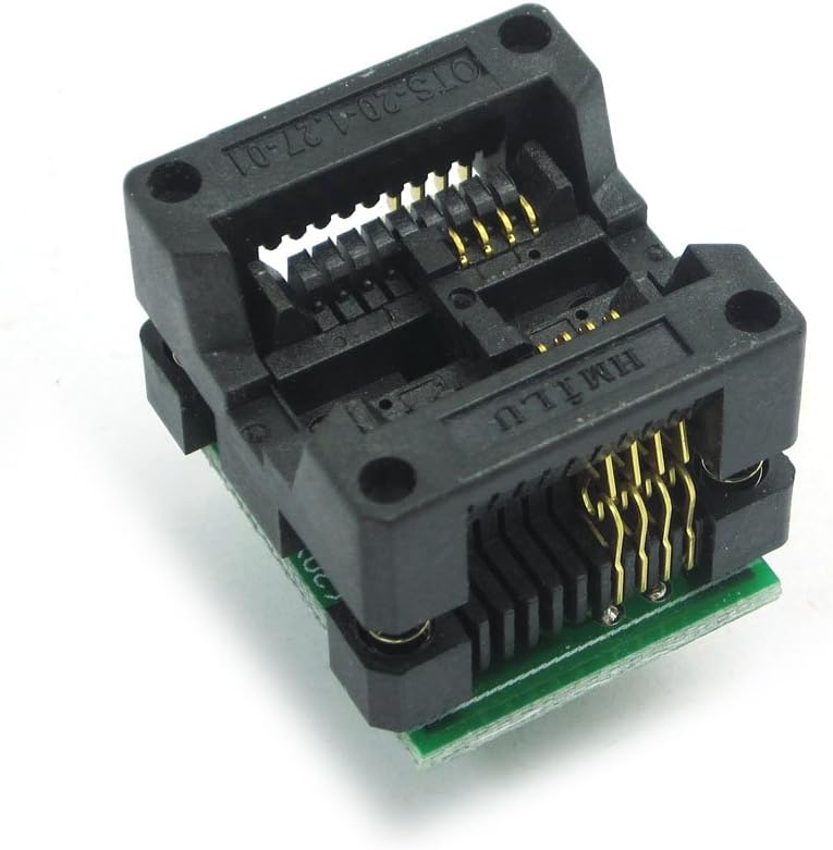

Programming header is not necessary. All process takes not more than 1s, so you may just only touch header pads during upload firmware. I'm using this method from v2.6 :-)
You can program an SMD component with this type of adapter outside the PCB on a breadboard before soldering the SMD IC to the PCB.
You therefore do not need the programming connection on the circuit board.
https://www.amazon.de/dp/B07DK2TNYV/ref ... k_detail_4
pancio
Beiträge: 321
Registriert: 31.08.2021 07:31
Has thanked: 313 times
Been thanked: 318 times
Re: UGV-II angekündigt
Beitrag von pancio »
Wow... I need to spend a week to find this kind of adapter in the drawers :D . Instead of this I'm using cheaper version:
Working as designed :-)
