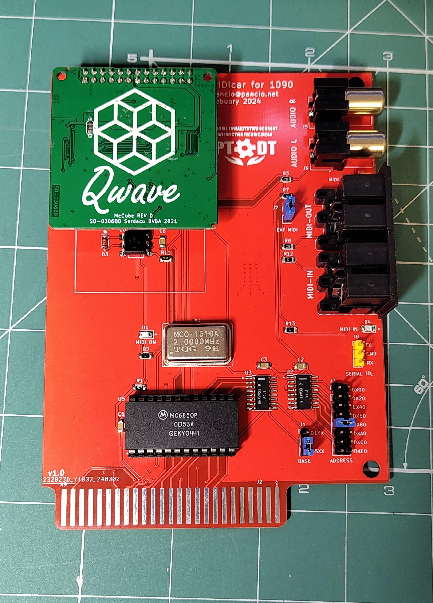

MIDIcar for 1090 interface
Long-short story:
You might remember that about three years ago, @PeBe and I worked on MIDIcar, a MIDI interface for the Atari XL with an ECI port. @PeBe made the MIDIcar Player that, in my opinion, is better than those for PCs. A year later, a version for XL computers was created, followed by a MIDIcar version for Atari 1090 users, which I wasn't able to test because my 1090 is still not equipped with componenst. I sent prototypes to several people: @ndary, @dely and @krap, and I quickly realized something was wrong. Nir even claimed the device worked, but I couldn't confirm it with others – so it was a legend!
@dely pestered me for almost two years to do something about it, and finally, one of the best Atari electronics engineers, @pasiu, took a look at the schematic and immediately knew what was going on.
Getting the interface working required the MC6851 to transmit a bus busy signal to /DBUFSEL in its address space, which I'd forgotten about at the time. Fixing this is quite simple: just a diode between the decoder and /DBUFSEL – so if you have my old MIDIcar 1090, it can be easily "repaired." Additionally, it turned out that the Wavetable module might not have worked because it required a pull-up of the RESET signal.
After testing with the manually applied fixes made by @dely, it turned out that the MIDIcar 1090 works without any problems! @dely's tests motivated me to make some corrections and create a new PCB – you can find it on my website.
Thank you guys for the tests!
I've already uploaded the schematic, design, and gerbers to my website...
Facebook thread: https://www.facebook.com/groups/savonar ... 342349502/
Have fun!
