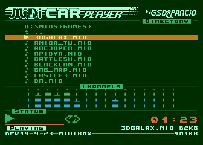

MIDICar Player dev-140923.
MCP dev 140923.png (7.63 KiB) 69248 mal betrachtet
mcp.atr
(130.02 KiB) 694-mal heruntergeladen
Novelties:
  • track time minutes:seconds view (request from @patjomki)
    It wasn't easy, but it worked out. For now, only the time from the beginning of the song is available.
    The 'T' key toggles time presentation modes: Hex MIDI Ticks, Dec MIDI Ticks, Min:Sec (as default) , Off;
  • when you load a song, next to its name (in the status bar) its size in KB appears (request from @Pancio :) )

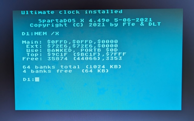

Today I tried this latest version with my 800XL that is now equipped with a 5V modification at the pbi bus.
While the program is running fine on my 600XL with my 800XL there are some errors.
After loading a midi file the file is not played instead it is immediately "STOPPED". When I try to load the same file again I get an error message "I/O ERROR #97"
Any ideas?

Both computers are equipped the same way. There are only two differences
1. The 800XL has a 5V modification at pbi
2. The 800XL also has a rapidus installed but completely disabled.
Apart from that both computers have vbxe, u1mb, pokeymax3, sophia2 and an avgcart with sio cable equipped.
Configuration:
1088kb Rambo, XL OS 1.3, Atari Basic C (but disabled with option when starting mcp), no SpartaDOS X, VBXE disabled, PBI BIOS disabled, Pokeys Single, Covox disabled, PSG disabled, SID disabled
Pressing X doesn't really help. One or two notes are shown to be played (but I don't hear anything) then the 800XL freezes. 600XL is running fine.
Midifile is the one I already posted thunder.zip few messages above

Montezuma hat geschrieben:
10.10.2023 21:44
Do you have U1MB ? Perhaps Pancio could help you with testing (he has an ATARI with U1MB)
No. I do not own a U1MB. I can talk to @Pancio in terms of testing.
Re: MIDICar Player
Verfasst: 11.10.2023 09:07
von Montezuma
PeBe hat geschrieben:
10.10.2023 22:12
So maybe I'll ask it in a different way.
Under SDX, with all optisions enabled, as shown by the `MEM /X` command.
Are there any free banks?
If not, the problem could be the RAM-DYSK being loaded during SDX startup.
You are right - there are only 4 free banks available:
SDX manual says:
"If there is no custom CONFIG.SYS in the boot sequence, the standard setup from the
CAR: device will install one ramdisk as drive O: and build the directory structure on it."
and I don't have CONFIG.SYS
Re: MIDICar Player
Verfasst: 11.10.2023 09:31
von Montezuma
Here is a solution for other users who are not familiar with SDX (like me).
I assume that the first HDD partition (configured with FDISK) is D3.
Copy original CONFIG.SYS from CAR to D3:
D3:TYPE CAR:CONFIG.SYS >>CONFIG.SYS
Edit the file
D3:ED CONFIG.SYS
Delete the line:
DEVICE RAMDISK
In U1MB menu, change CONFIG.SYS configuration from default to D3.
